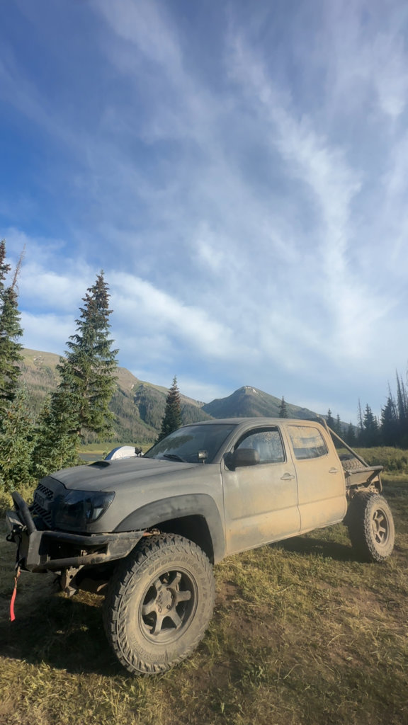

    Here’s a pic of the truck, picked it up for 2k, been adding things here and there and doing maintenance trying to make it my off-road rig.

    Truck looks pretty modified, maybe the parking brake cables can't handle the added suspension travel and could be pulling and therefore braking? Haven't really looked at how the cables are laid out and mounted so maybe this isn't possible
