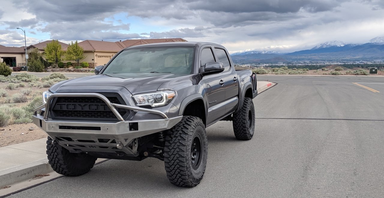

    Making some progress...
    @At The Helm Helm front bumper fitted up and getting ready to powder coat. I love this bumper. The lines are great and for my non-ME ass opinion, I think the construction is on point as well. Morgan is great to work with, on time, great work ethic, and a solid dude. I highly recommend you give his bumpers a look.
    @RelentlessFab front skid and rear HC w/swingout installed as well. The rear survived a rollover and its hardly noticeable, not even a little bit out of square. So yeah, that passes the smell test with flying colors. Nice work, Eric! You guys do great work.
    "I love it when a plan comes together." I installed the extra leaf in the Icon RXT pack, Option3. She's riding like the A-Team van, but still lacking the spare, shell and some other crap that may have perm residency in the bed. I initially installed the RXTs in the default config which was level and a great ride unloaded, but she sagged pretty good once I installed the HC bumper.

    BAMF grill 2.0. The original vers looked pretty beatup against the new bumper and fresh powder coat so I figured it was time to cut into it and clean it up.
    Cut 50% of the weight, removed the nasty plastidip the PO sprayed on it, and repaired some damage. Should look pretty nice once powder coated.
