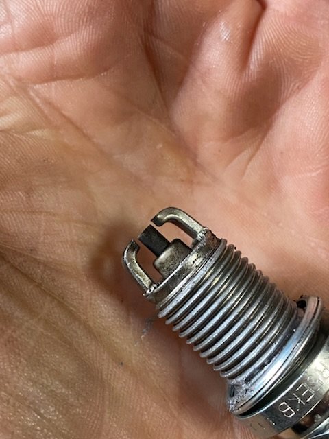

    On pulling the plugs, I found cyl. 2 had lost its electrode entirely. neighbor guy seemed to have fixed other vehicles on the farm without them busting into flames, and on recommendation of my friend, I left him to replace coils and stuff, as I was barely able to stay awake. So I didn’t see what if anything he did wrong.
    I decided I wanted to scope around and look for the electrode and do a compression test.
    Fast forward to when I start up the truck the next morning to move it out of the rain and into the barn to work on. It’s running rough and has little power, and CEL is still on.
    Out comes cyl. 2 plug, which is not seemingly too loose, and fairly covered in carbon.

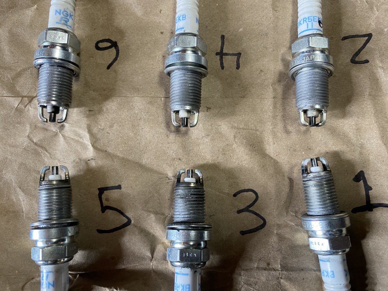

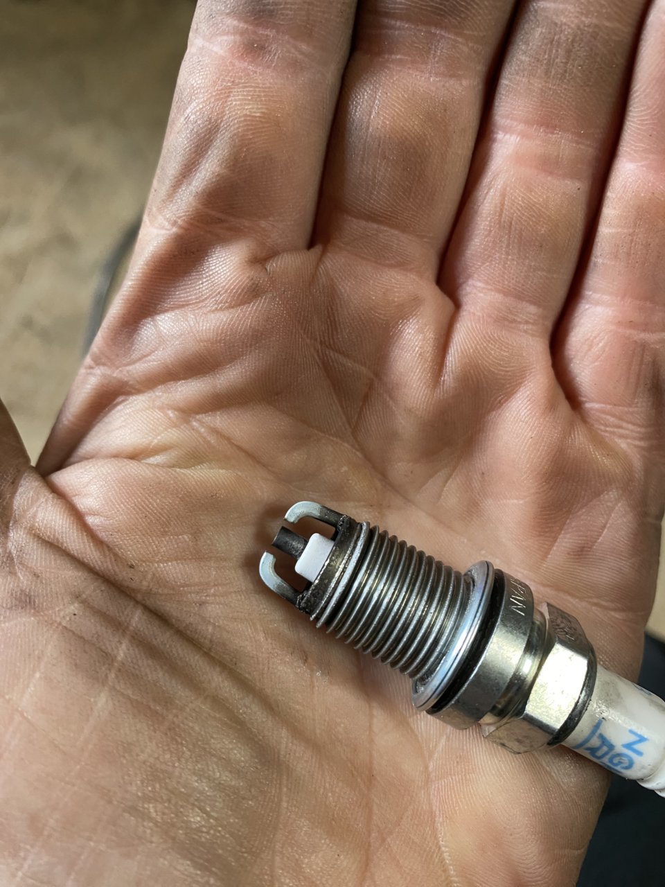

    here’s first thing that stumps me. All the plugs on the passenger side, with the coils on them, are very carbonized. these are the new ones that have driven 500 feet.
    all the plugs on the driver side look new and shiny.
    I put everything back, as best guess as I can to torque spec without an actual torque wrench. Start up the truck, seems off that’s before- hard to put it in words, but lower pitched and slower. I am used to an around 1k or 1.1k idle, it’s at about 800 ish. Rougher maybe, but it’s slight. There’s also a noticeable gas smell in the exhaust. I take it for 1/4 drive down the ride and it’s very sluggish and backfiring (not big bangs, but definitely some sort of misfire) with low power. I could barely get up the small incline back into the barn.
    Come back, plugs are still carbonized on one side, and clean on the other. Checked, they’re the correct coils (at least for unbranded autozone ones). To test, I put the old coils on. The truck seems to start up more eagerly, and has maybe slightly more power, but still ‘backfires’ (still not ‘bangs’ but more like ‘poofs’). CEL is on but not flashing. I’m attaching a bunch of photos, I can’t figure out why plugs on one side would be carbonizing.
