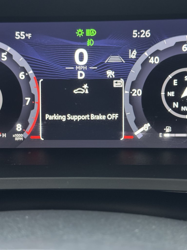

    So just to wrap this thread up, if you have a premium package and/or the towing tech package that includes the Parking Support Brake “PKSB” feature, you’ll need to disable it if using a bike rack, or anything else that doesn’t use a 7-pin connector. If plugging into the 7-pin, it will be automatically disabled, ie, pulling a boat or camper, etc. Once it’s manually disabled in the MID, it will remain disabled until re-enabled by the driver; it will remain off even when the vehicle is shit off and restarted.

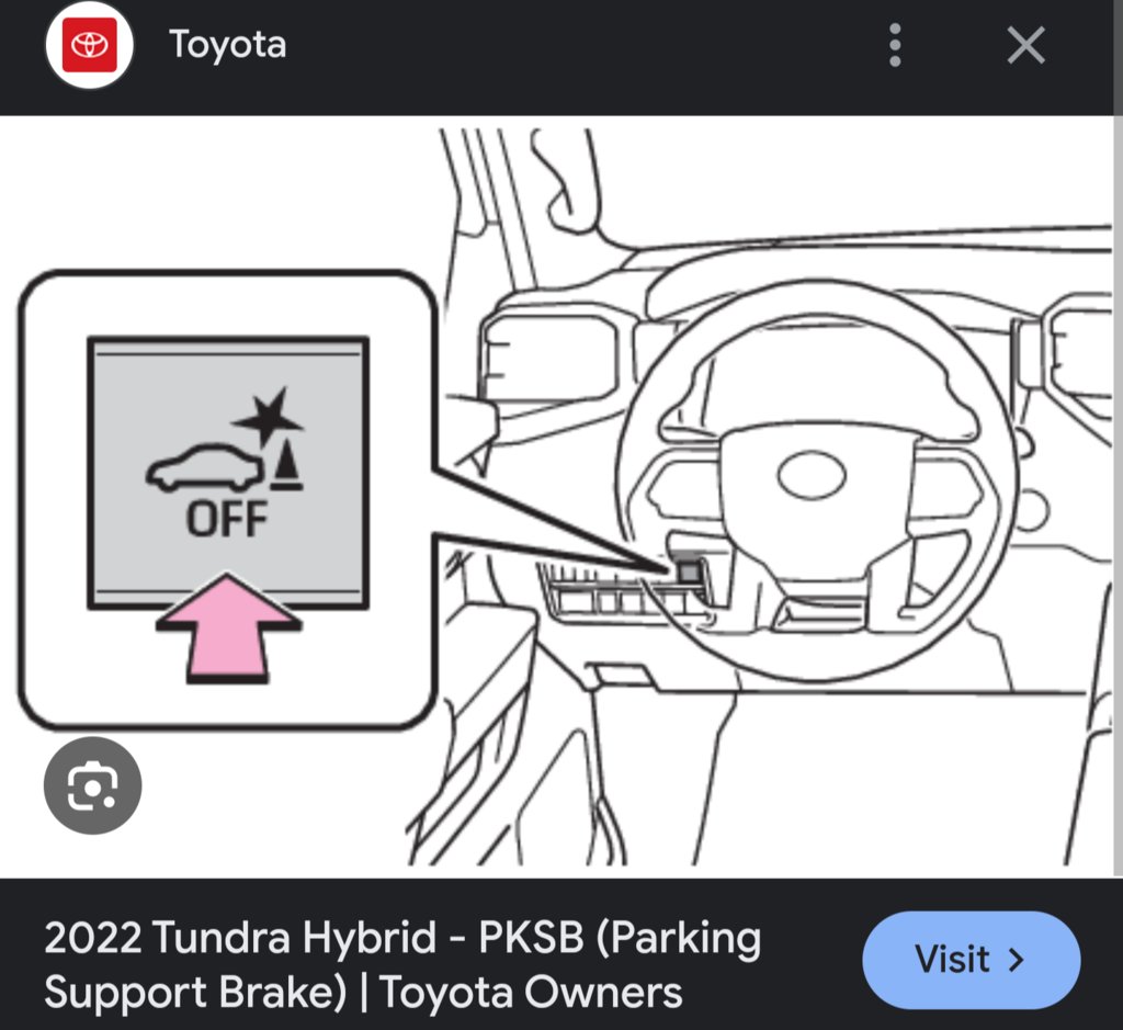

    Why this wasn't included in the Tacoma is mind blowing. Tundra has it

    That’s what I expected to find and would be much better than going into the MID menu each time. Oh well.

    and it reminds you CONSTANTLY that it is off. there is a warning light to indicate, and a message that keeps reappearing. i need to find a dummy 7-pin connector that just serves as a bypass for when i use the bike rack.

    it didn't work, at least not as a simple plug + play. there does seem to be a way, but i have not figured out the appropriate series of steps yet. because it did recognize "trailer attached - hold ok to confirm" one single time in my test runs, after i was playing around with adding a trailer and/or setting up the backup guide, and that did disable the PKSB setting (and one other) which resulted in NO beeping backing up with the rack. but then i was unable to repeat it a second time. so i think no matter what, it would still take a series of steps to get everything disabled, probably not worth the trouble. i can't believe this isn't something they would think to make simpler.

    yes, but it still SCREAMS at you while backing up, and sends persistent notifications that it is disabled. it can be very annoying to people who want their truck to shut up and just be a fucking truck.
