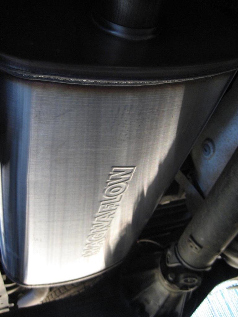

    Great minds.......we have the exact same Magnaflow muffler except mine is 3"

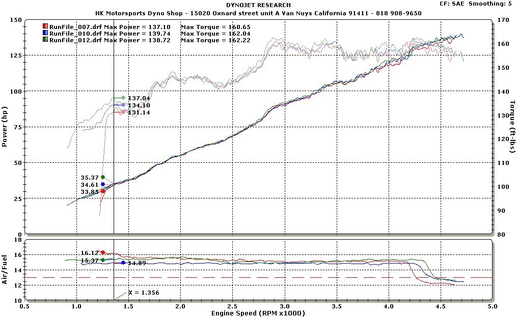

    I totally agree. It's all about reflected pulse timing. The longer you can make the "plumbing" on both sides of your engine (intake and exhaust) the more torque you'll get at lower rpms because you lengthen the elapsed time of the reflected pulses by adding more distance for them to travel. Longer distance, more time, lower rpms affected.
    I originally went from stock to Magnaflow and then from Magnaflow to Flowmaster. When I dyno tested all three mufflers head to head, Flowmaster won. As you can see from the chart, they're actually all pretty close.
    Red: stock.
    Blue: Magnaflow
    Green: Flowmaster
    The Flowmaster Series 50 Delta Flow muffler lowered the peak torque by 100 rpms from 2,900 to 2,800 rpms (stock peak is 3,800 rpms) and was slightly better overall at lower rpms.
