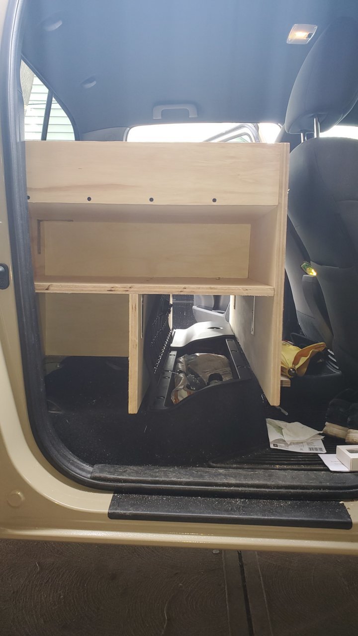

    Hey all!
    I was recently looking for ideas on how to build a storage unit that replaces the back seat of a double cab. Had been thinking about it for a while. But both myself and the girlfriend were furloughed, so we decided to go on a road trip. This meant I needed to get it done asap with very little planning. Couldn't find any substantial builds online and ended up winging it on my own. Figured I'd share what I remember about the build.
    My wish list was short. Bolt into existing seat mount points. Multiple cubbies, not just one big box. Don't cover any of the windows. Allow access to the existing storage in the floor.
    I had written a big long walk-through, but I screwed up and accidentally deleted the whole damn post. I imagine y'all will figure it out just from looking at the pictures. Some essential details, though.. The back panel can go up to 54" wide with a little tapering on the top corners. The rest should be no more than 53" wide. I decided to bolt into the four 10mm bolt points along the middle of the wall. Replaced the bolts with 10mm 8.8 bolts, 95mm long with only about an inch of thread. There are other options, but this seemed the simplest at the time. I did foam behind the back panel for a bit of noise reduction. Cut out a patch where the window motor protrudes. I found the best way to mount the front panel is with hinges like they did the seats. This is because the surface isn't perfectly vertical. I imagine you could fab up some custom brackets with the perfect angle, but this way was quick, easy, and very effective. Once you have the front and back panels cut and mounted, measure and build the rest as you go. Might make some modifications or improvements in the future, but we've been camping for a week and it's working great. It's strong and unmoving. You can grab hold of it and rock the whole truck.
    I am not a carpenter, nor an engineer.. so this isn't perfect or anything. It took 4-5 days of me learning as I went and several trips to Home Depot. But please ask whatever questions you like and I'll answer to the best of my ability.

    Wow. Phenomenal execution on your idea. :bowdown:

    Using those hinges for brackets was a great idea. Simple and effective

    I've seen a handful of "rear seat delete" projects while folks have been sheltering in place & OP's is probably the most useful but also the least permanent. I didn't see anything that can't go back to stock if he changes his mind. I'm a fan.

    Very cool storage system, OP. It looks great. And you still have full rear and side visibility.
