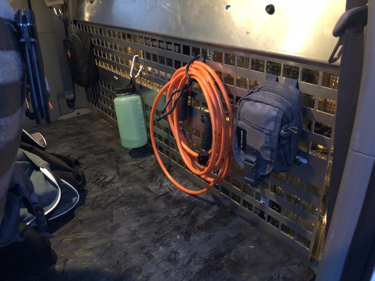

    That is the set up I have. You will need to trim 1.2” off the bottom of the molle panel for it to fit.
    Not sure what you are asking. Are talking about the bottom deck that replaces the Bottom portion of the seats or the back panel that replaces the Back portion of the seats? Both require removing all portions of the seat they replace. I don’t have the GG back panel so can’t say if you can keep the bottom part of the seats in place and have that back panel in place.

    Can you take a picture of your setup? What did you use to cut your goose gear plate?

    I didn’t cut the GG plate. I trimmed the Molle panel.
    I clamped a piece of angle iron to it for a straight edge then used a Sawzall reciprocating saw to trim the excess off. Ran a perfect straight edge for 90% the length and then got wonky when I got to where my son was holding it down for me. I used my angle grinder to clean it up. Had I gone slower and been more careful I would not have needed to. Hit it with some paint and it was good to go. image.jpg
