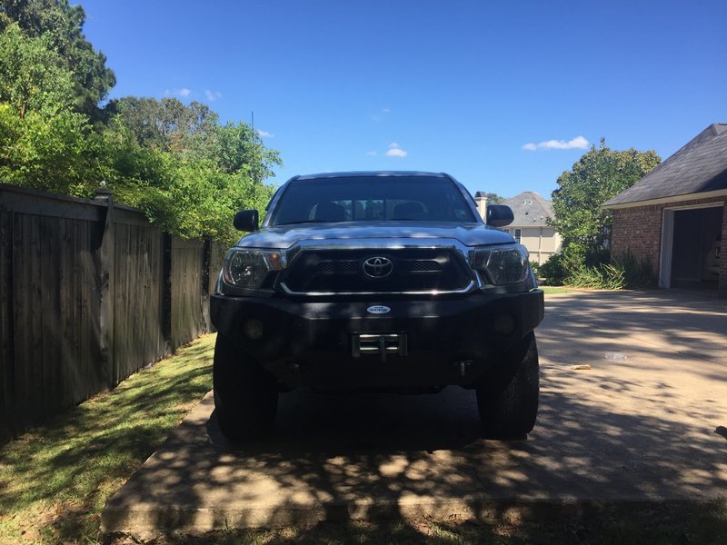

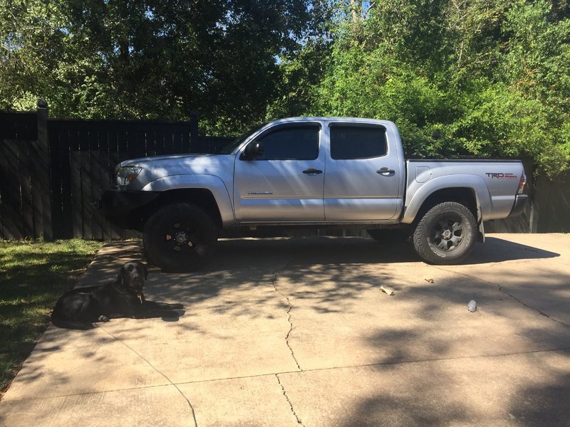

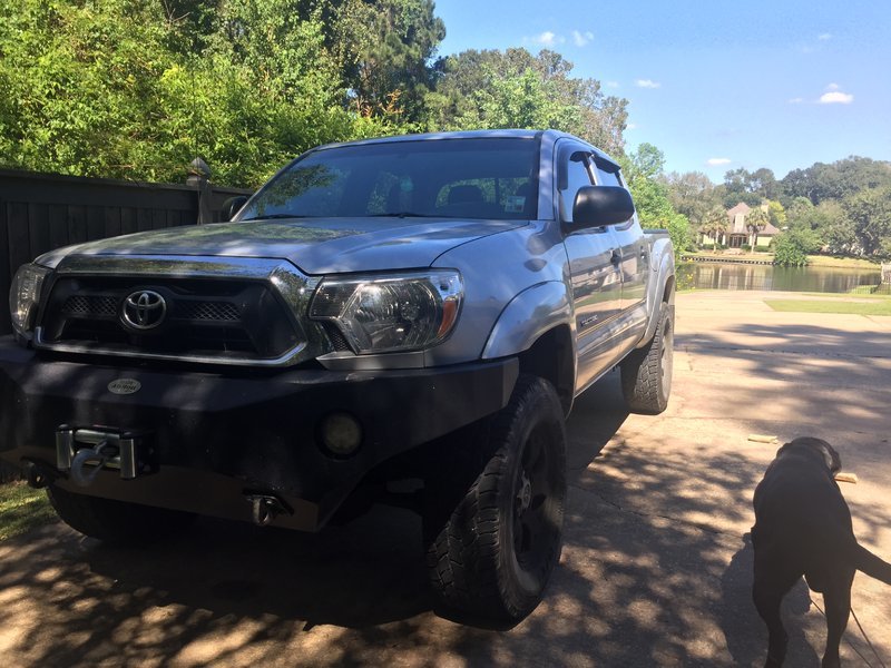

    Got any pics of your current setup? Seems to be a pretty wide stance already

    I got 16" rims right now

    Thank you! Yea I want to get adjustable bilsten shocks to lift the front end up a little. To level it out with the back. The custom front bumper and winch is making it sag a little.

    You might want a coil with a higher spring rate also. Tons of great information and people on here!!!
