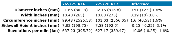

    265/75 16 will be as high as you can go without lift. If you want 2" of wheel/tire sticking out of the well, it won't happen with the 265's

    You should be able to do a 275/70 16 with out issue. (If they make such a tire size)
