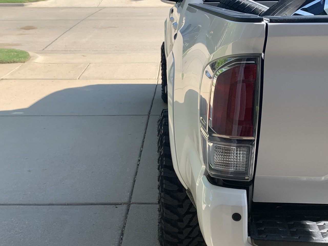

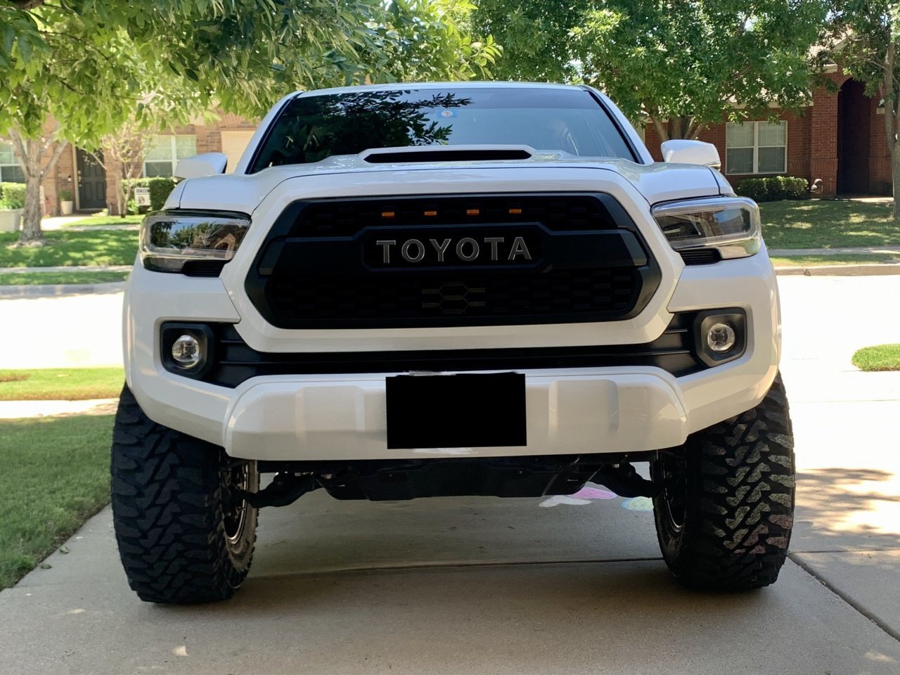

  16. Jun 2, 2020 at 4:20 AM
    #16
    GDESMOND1976
    GDESMOND1976 Desmo
    Jun 1, 2020
    #330011
    376
    Geoff
    TEXAS
    2020 TRD SPORT, WHITE, RWD
    WEATHERTECH FLOOR MATS, DESMO OVERLAND STAINLESS TRD FLOOR MAT LOGOS, 3" READY LIFT, TINTED WINDOWS, BLACK RHINO ARMORY WHEELS 17X9.5/-18 OFFSET, YOKOHAMA GEOLANDER MT 33-12.5/17 TIRES, TRD PRO GRILL W/ 4 AMBER LED LIGHTS, CUSTOM VINYL HOOD STAMP, TEQ GRILLE BADGE, STEERING WHEEL BADGE WHITEOUT COVER, TACOMA TAILGATE LETTERS, DESMO OVERLAND CS CONNECT MOLLE, DESMO OVERLAND HL CONNECT MOLLE, ORCA TACTICAL MOLLE RIP-AWAY EMT MEDICAL FIRST AID POUCH, ORCA TACTICAL MOLLE H20 MULTI-CAMO WATER BOTTLE POUCH, RYMMES GUN MAGNET MOUNTS, IGLOO IMX 72 QT COOLER/BED MOUNTED.
    17 x 9.5 with -18 offset
    4.5 backspace BLACK RHINO ARMORY
    tires are 33-12.50/17 YOKOHAMA GEOLANDER MT GOO3

  18. Jun 2, 2020 at 4:39 AM
    #18
    GDESMOND1976
    GDESMOND1976 Desmo
    Jun 1, 2020
    #330011
    376
    Geoff
    TEXAS
    I have no rubbing, zero cutting, 3" lift, mostly on road driving. adjusted caster to 1.5 positive to move wheel forward. Inner fender plastic in front, I was able to make new mounting holes and just tuck the black plastic tighter into the bumper without cutting.
  19. Jun 2, 2020 at 4:47 AM
    #19
    GDESMOND1976
    GDESMOND1976 Desmo
    Jun 1, 2020
    #330011
    376
    Geoff
    TEXAS
    front inner clearance is over an inch and clearance at cab mount is about 3/4". front plastic did barely rub when in full lock when I installed new wheels and tires, that is why I tucked the inner fender in. FYI, check actual dimensions of tire from manufacturer, some can be an inch different from tire to tire even though the "size" is the same. I have actual 33-12.50/17. the diameter is actually 32.6". I was able to fit the 12.50 wide because of diameter being a little shorter. Most 285 tires run at 33" or even sometimes larger. The diameter of your tire will cause more rubbing than the width (depending on how extreme the width, especially if truck isnt lifted)
