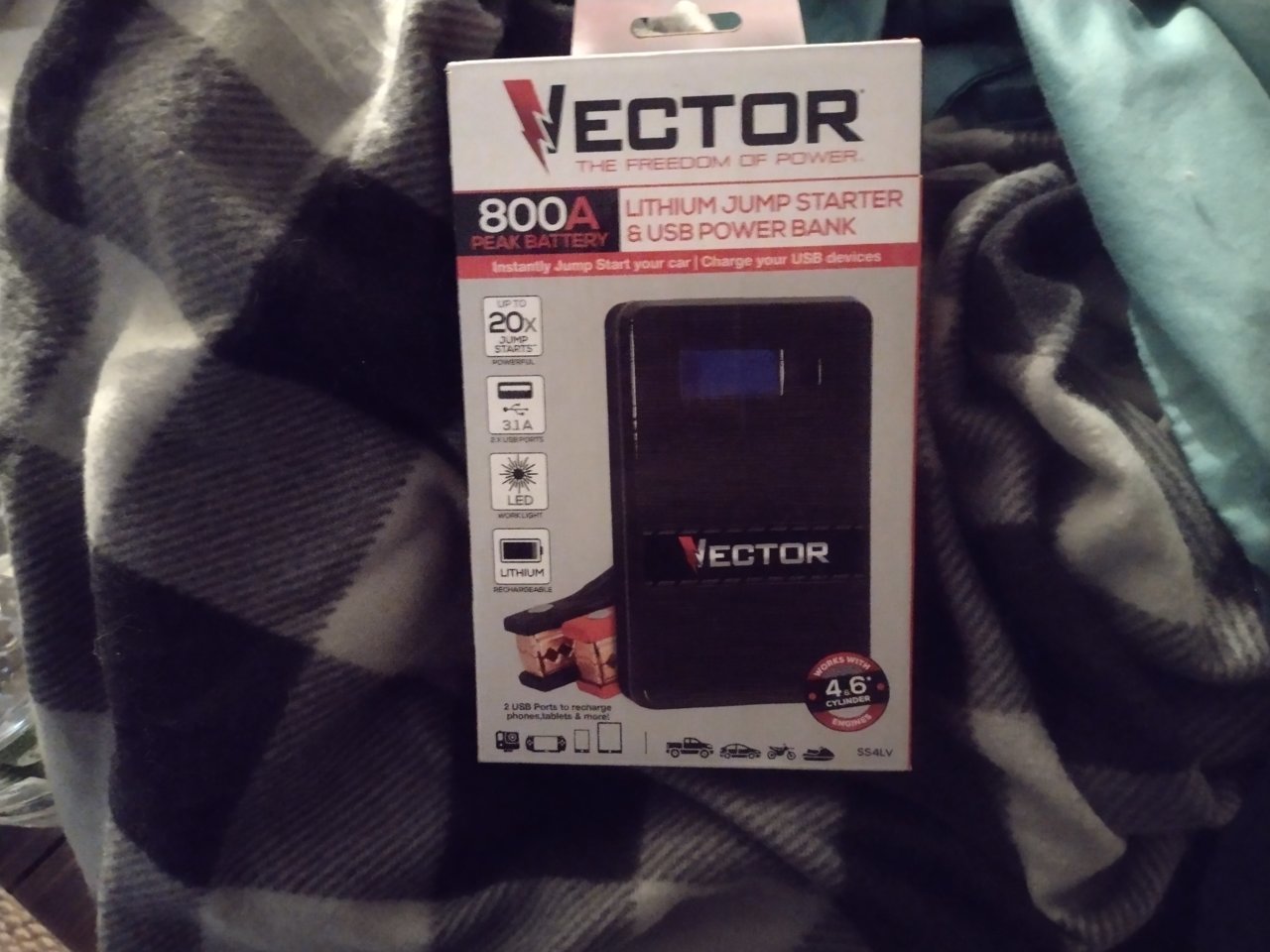

    I think this is a good bang for your buck. Charges my phone and worklights fast. At least faster then my usb port. Solar kits for rvs are nice.
