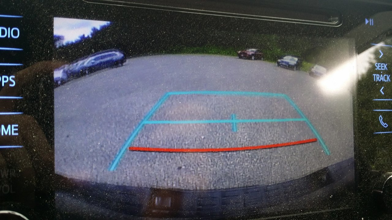

    So today is hot and humid. 95 degrees and bloody gross humid out. Get in my truck and the backup camera looks like its vibrating. I checked, camera is not loose, harness looks undamaged and its plugged in tight.
    I mention weather because i work for volvo and they have had issues with hot weather and their cameras. I know being in nh i dont experience heat like some other members here, anyone else had this issue?
    Edit: snapped a pic but it just looks like i used a shitty camera. And yes i know my screen is filthy. Even the guide lines were blurry and shaking

    Did you clean/wipe the lens off? It gets really dirty easily.

    Yep, check that first. I always wipe off the lense when I first get in and the truck is covered in dew.

    I can see in the image that the video being fed to your display is very poor quality. Is it on going issue or a one time/random deal?

    Have you made any electrical upgrades recently?

    No mods or upgrades, not a dirty lense, if it were a hardware issue i dont think the guidelines and screen edges would display shaking/blurry

    That almost looks like EMI or poor shielding / grounding on the camera or connectors.

    Tomorrow ill try to figure out who makes the camera for our trucks and see if its similar to the ones in problemed volvos. Problem looks identical and i know those only act up in 100+ degree weather. Id be shocked if a nh truck was the first with a heat related issue though

    Update: worked flawlessly this morning. Worked right at lunch. Blurry again leaving work. Outside temp 96 and sunny. Looked up volvo tsb and it calls for an inline filter for interference causing blurry image to appear and in extreme heat screen displays blue. related to outside temperatures over 90 degrees. Ordered filter, no clue if it will fit my tacoma but its a 2 pin connector so maybe?
    I feel both special and confused. Certainly my tacoma isnt the first to be baked in the sun on a 95 degree day. And far from first time it cooked

    If it helps OP, I live in southern california and I have backed my truck in 105+ degree weather. But its desert dry heat not humid. Maybe it could be the humidity....
