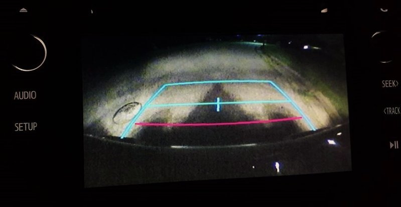

    night picture from camera with lights on
