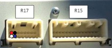

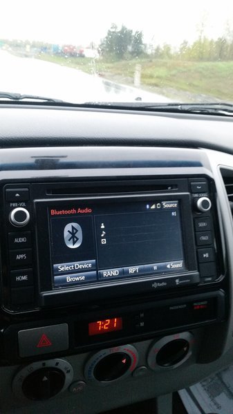

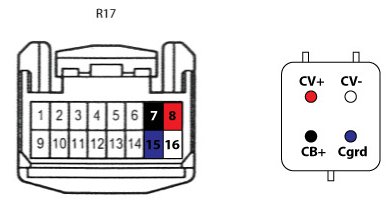

    So I got a 2011 that I put a Bluetooth touchscreen head unit out of a 2013 in. Swapped over everything no problems a while back. Now the rear view camera install is gicing me grief. I bought the 24 pin connector for the rear of the HU. Split the signal going to the rear view mirror down behind the ebrake kick panel. Patched in some shielded cable to the deck. But I can't figure out the pin out formation on the back of the HU. Can someone help me out pls. Im getting frustrated.20170417_192142.jpg Screenshot_2017-04-17-19-21-27.jpg

    R15 pin 2 would be the reverse signal. top row pin second from right
