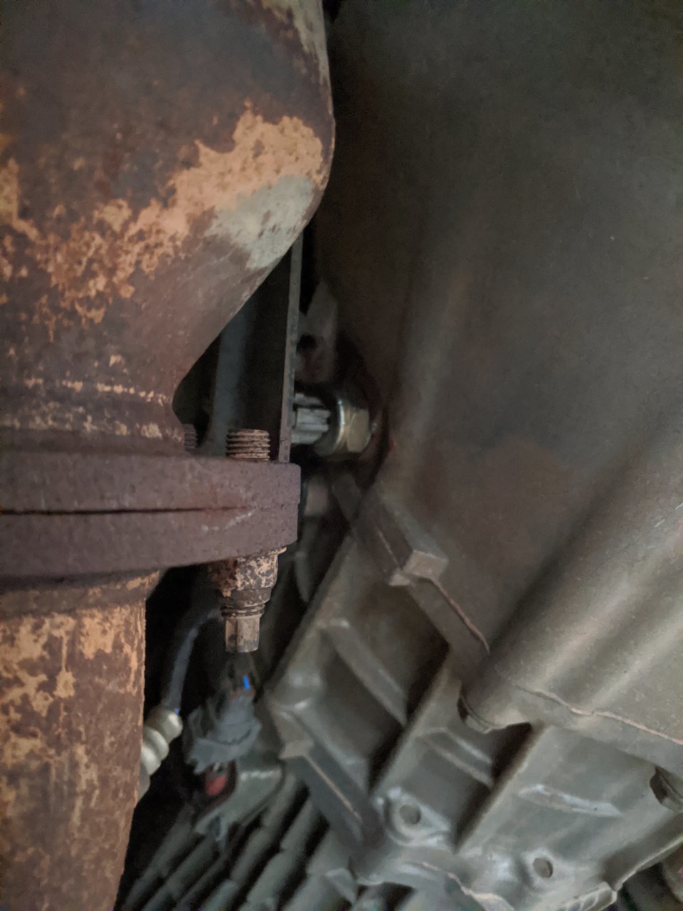

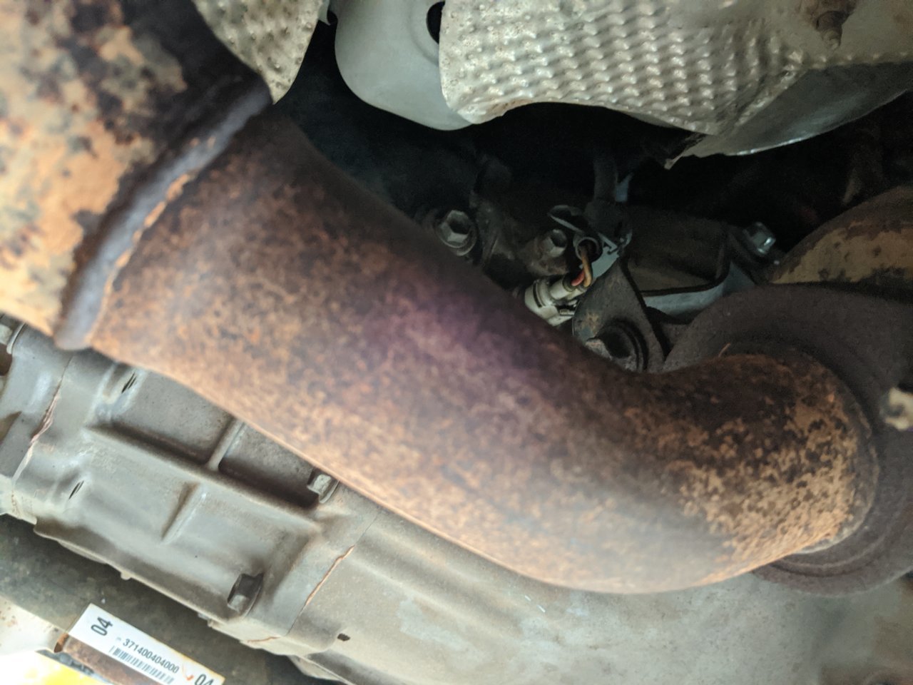

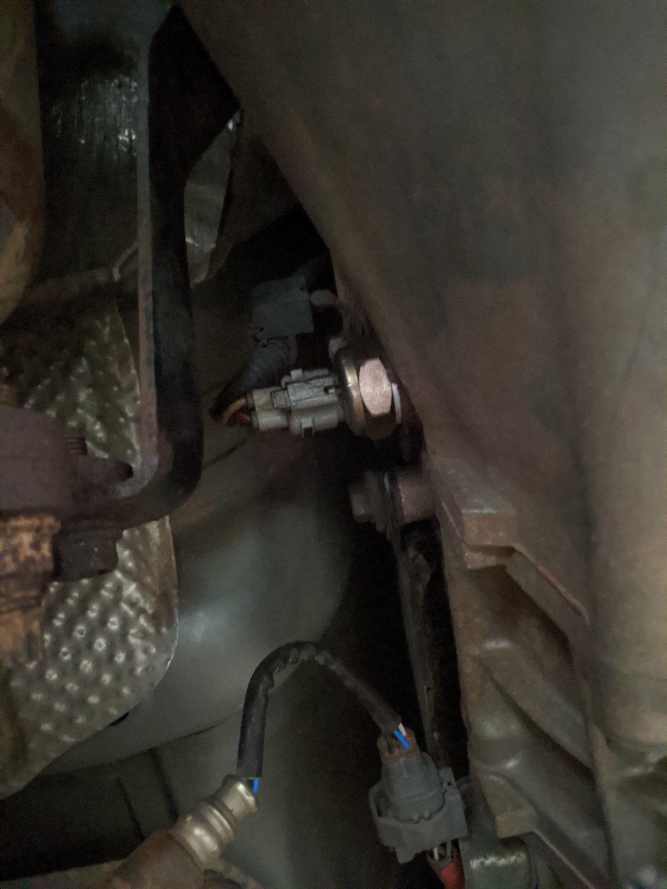

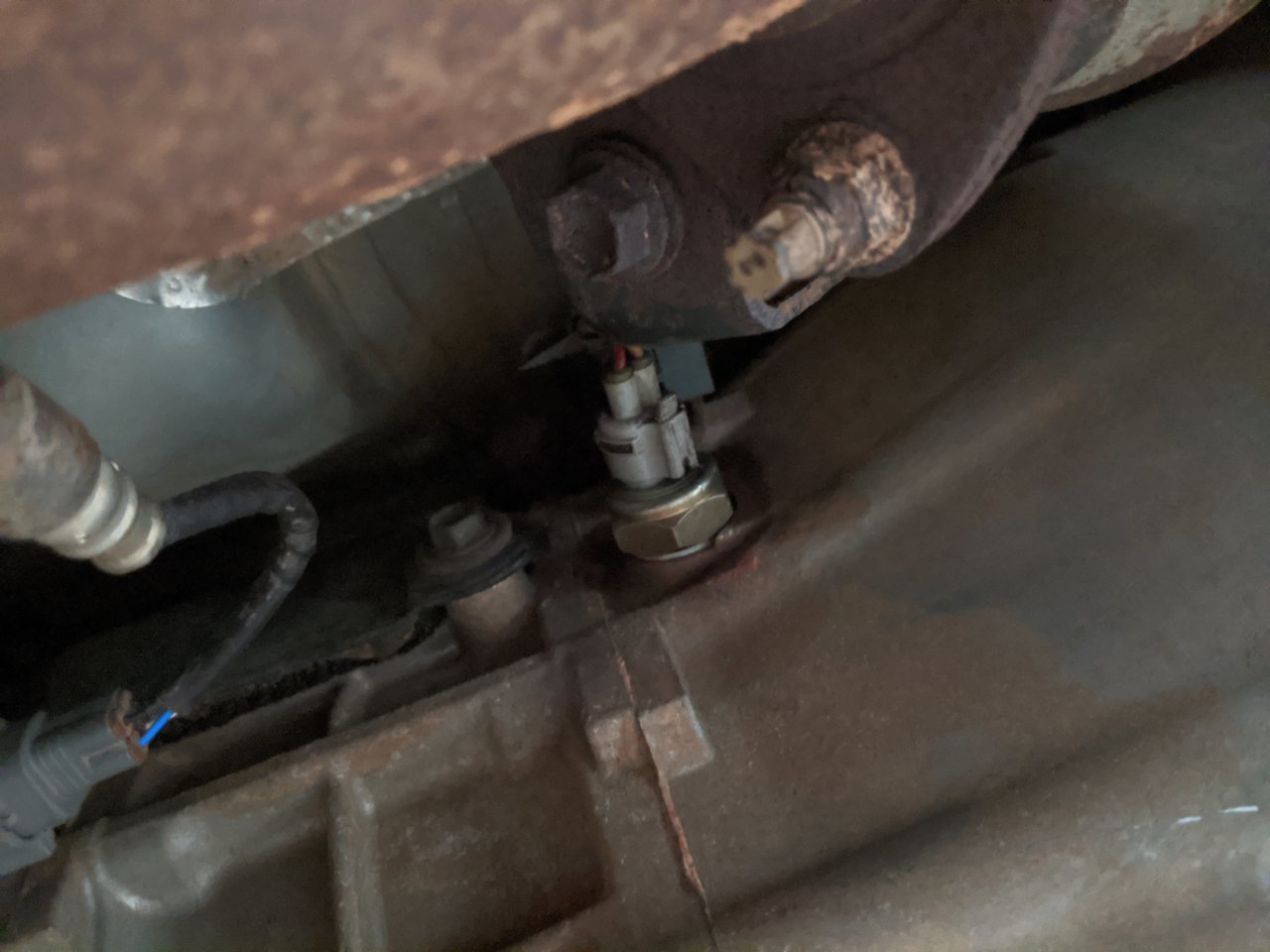

    Ok, so it's on the transmission, just under the passenger seat side.IMG_20191204_143131.jpg IMG_20191204_143113.jpg IMG_20191204_143023.jpg IMG_20191204_142950.jpg

    Seems easy enough. I'll try that out. Probably order an OEM part though
