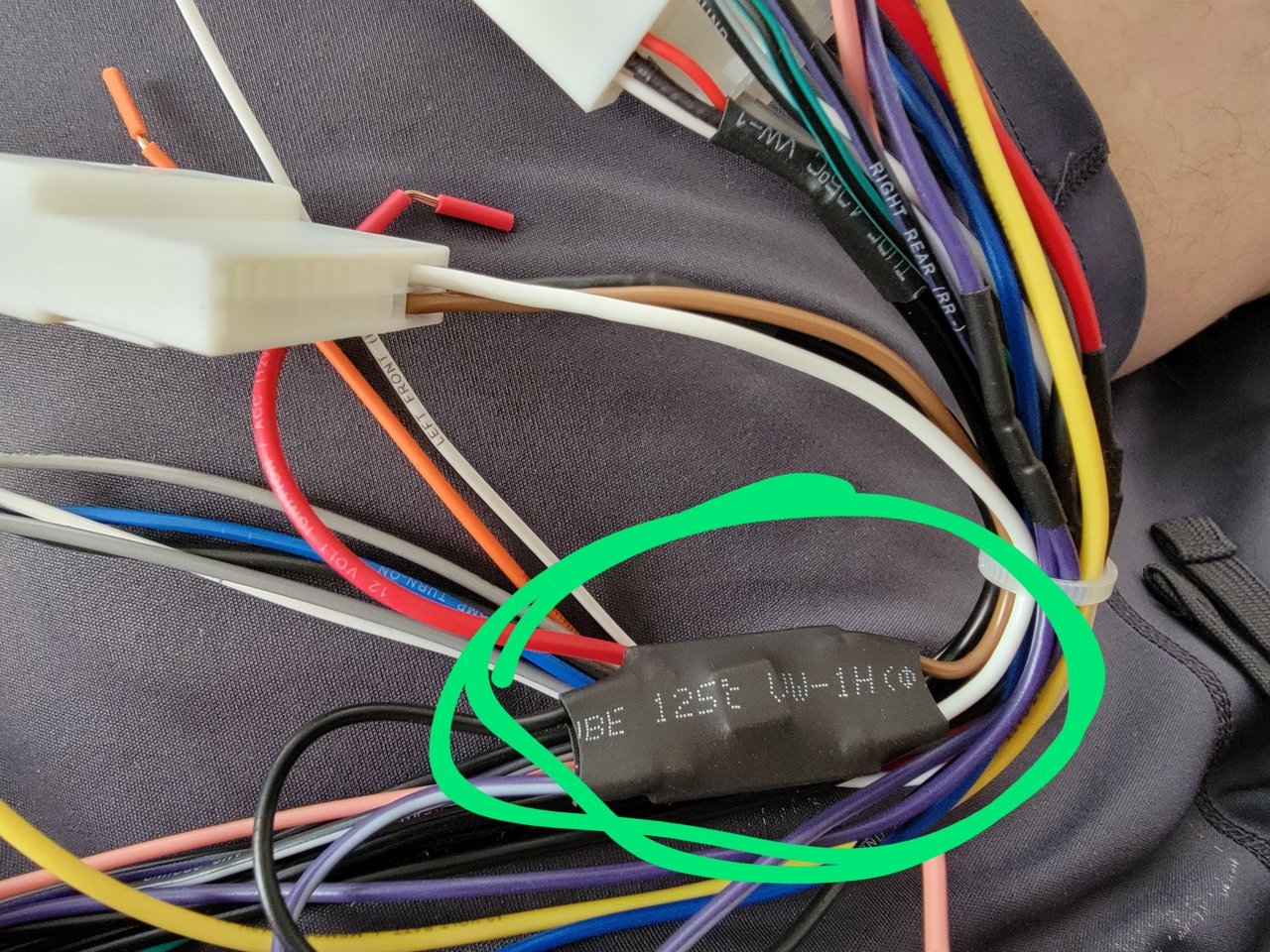

    So we learned more about the harness and figured out the problem. Circled in this picture is the capacitor that steps down the voltage. In the original harness they had the wrong capacitor so the camera was not getting enough voltage. Once we swapped it out with the correct one on the new harness they sent out, the camera works perfectly.

    I have to call out something:
    Capacitors do not step voltage down or up.
    You drop voltage with ether resistors and/or voltage regulator ICs, then a cap to smooth the voltage ripple out

    I know nothing about electronics so I am sure I am using all the wrong terminology.
