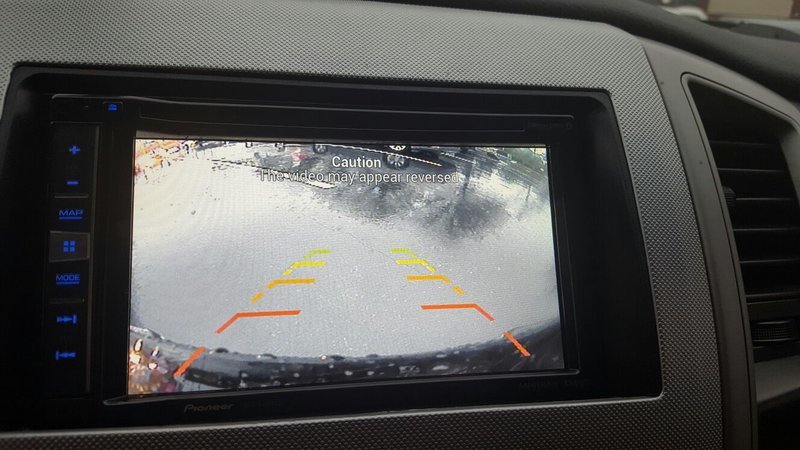

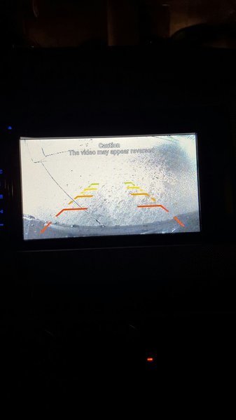

    Hi,
    I just had a handle camera installed. I am not happy with it. I am not sure of the brand bc the shop I used got it.
    1. The angle it is at points down, the shop states they cannot adjust it any further.
    2. The video quality is not that great. At night the white balance goes up so much I am unable to see at all just an all white picture.
    I used the shop bc it has great reviews, I am unhappy with the shop but I have already purchased the product and services. Does anyone have any suggestions on brand or camera type? I may just have to go with back up camera that attaches to the license plate.
    HU: Pioneer 5201NEX
    thanks all,
    rolo
