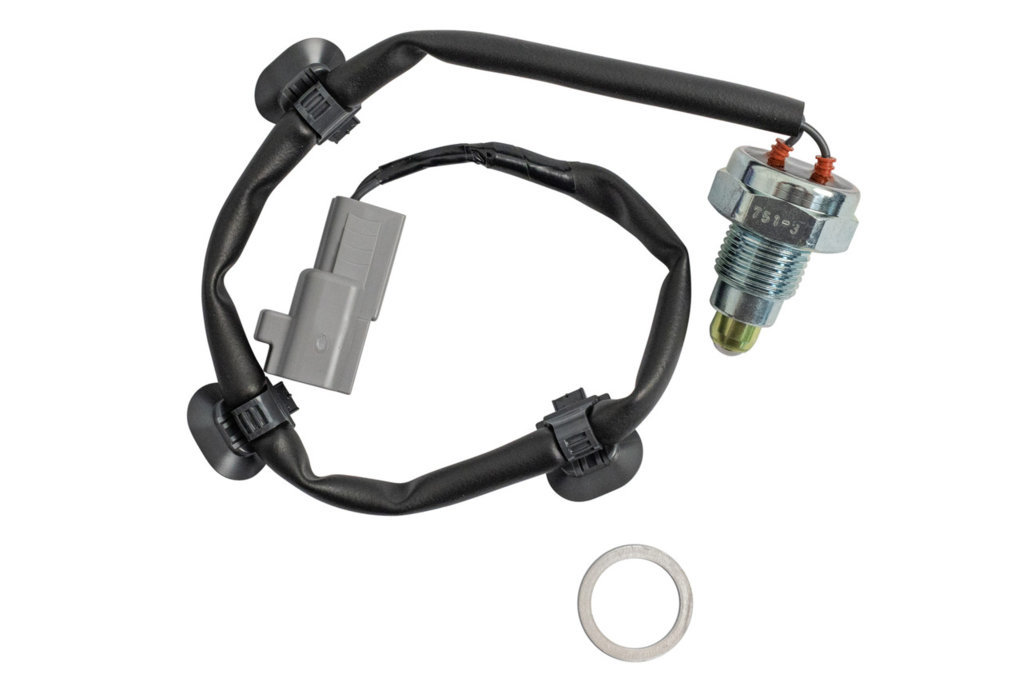

    I have the same issue in my 2017 manual OR but my reverse lights wouldn't turn on either. I had the problem before I replaced the head unit and after. I tried running down the problem and I came to the conclusion that it's the reverse sensor in the transmission since I can turn the rear camera on from the head unit.
    Ordered a sensor to replace it, Part 84210-52050, but I think it's for the auto Trans. I leave the country for 12 months in 3 days, so it's a next year problem for me.

    I'm still overseas and haven't been able to diagnose further. If you're able to use an anytime camera to switch on your rear camera, but it's still hit or miss sounds like a wiring issue somewhere.
    The part number I posted above I'm fairly certain is an auto trans sensor. It's not super expensive if you want to get one try swapping the old sensor with a new one though.

    That doesn't sound like a sensor issue to me. That definitely sounds more like an electrical issue somewhere between the camera connection and where it connects into the head unit. I'd say pull the head unit and check the connector that plugs into the head unit on that end.
