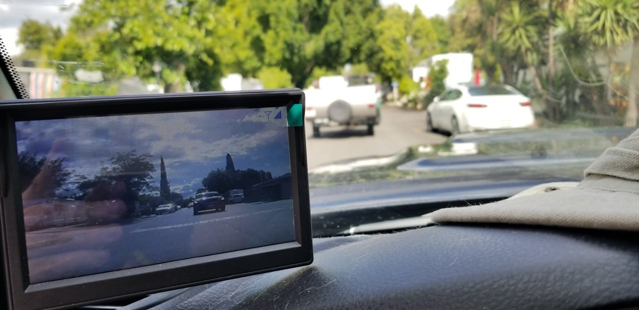

    I run a 7" screen for my trailer. I used to run a 5", that screen could fit easily in the left corner of the dash.
    I love them for what they are but there are plusses and minuses. :D
    They're ok for full time rear views but have a lot of drawbacks. For one, early morning and late afternoon sun starts interfering with the camera. Whenever the sun sits low it blinds the lens and throws weird glare effects.
    Also, they are such wide angle lenses that any car that appears in the far distance is actually three seconds behind. If you can see the car clearly it's already tailgating you. They are great for checking on who is riding in the left and right lanes just behind my bumper, but they are so myopic they even make a mirror look far-sighted by comparison.
    I can demonstrate:
    Here's the 7" screen: the trailer bumper is sitting in my garage threshold, note that the wall 21 feet behind is already a third of the screen away.
    Here's the old 5" screen; this is a unique selfie. My camper is being valet parked while I'm watching myself follow behind it (never change, Hollywood RV :cookiemonster:):
    Note the parked car for scale. I'm about 2.5 car lengths behind here, which would have been well within tailgating distance if this were on the road. Note how small my truck looks on the screen.
    Also also, they are cheap for a reason. That 5" set burned within a year. The camera on the 7" system is still going strong, but it's already had to have the monitor replaced. One of these days I might quit being a cheapass and replace the whole thing with a furrion system.
    The point is, if a some wildass approaches dead on your six and they are coming in hot, you won't see them until they are on top of you. Its happened to me a few times.
    Again, great for checking blindspots and wonderful for backing in between a tight cluster of trees. As a mirror replacement? They aren't great; but they're better than nothing.:hattip:
