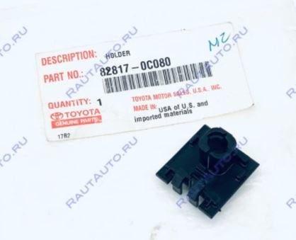

    One of the clips that holds the wires that go to the backup camera (on tailgate) has broken somehow. This is causing the bundle of wires that goes to the backup camera to get pinched sometimes. I would like to replace this plastic clip so I don't break the wires to the camera. I use my bed a TON for work so I want to be proactive in avoiding any damage.
    I popped it back into place but it's all bent up and loose so I don't think it will stay in place for long.
    Does anyone know the part number and where I could purchase this (hopefully cheap) item?
    Here are some pics of the situation:

    can't find a part diagram of this anywhere online. maybe i'll have to make a trip to the dealer to get this fixed.

    got a better pic of the unbroken clip. both are the same it looks like. Even got some writing on it so maybe that'll help.

    Crap, I just threw two of those away. Find someone installing the tailgate lock kit as it comes with new ones as you have two wires and it tells you to discard the other ones.
    Also, that last pic looks like it is not broken? You slide the side opposite the tabs into the bed and then pivot it in and the tabs lock it in.

    yea, there's two of them. one on the tailgate, and one on the bed. i removed the one on the tailgate side to take a picture but the broken one is on the bed side. they are the same part.

    @cryptolime I just installed the tailgate auto-lock. I have 2 of these available. PM me your address and I'll mail it to you.

    Jon was kind enough to send these to me. Looks like I'm getting the part I need! Thank you!
