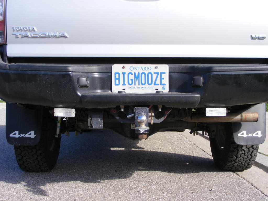

    I bought a set of these: http://www.amazon.com/Pilot-WN-PL250-Navigator-Backup/dp/B000OS7UU6 from Meijer. About $20 for a set there.
    I have had them for over a year and they work great.
    Mine are wired to a rocker switch in the cab, so I can turn them on at any thime, regardless of ignition power being on or not.
    I use them for backing out of longer driveways, hooking up to the trailer, unhooking the trailer, general lighting while camping/fishing. Very useful.
    One thing though... I got a little too ambitious last weekend and folded one of them back under the bumper when I tried to drive through a ditch. The departure angle is slightly less with the lights on the underside of the bumper :). No harm to anything other than the light, though I did bend my 7-pin connector a little. I just replaced the light.
    For the price, I'm impressed.

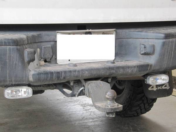

    I have a $40 pair of fog lights from Kragen mounted in the same holes under my rear bumper. They have been there for almost two years, and were on a 2wd Dakota before that. They make a huge difference in light with the tinted windows. The trailer hitch hangs down enough that they are safe unless you are a serious wheeler. I am not. Mine are wired on a dedicated 12 gauge wire with a relay directly from the battery. Three way switch on the dash for on, off, and on with factory reverse lights. Totally worth the time to set it up.
