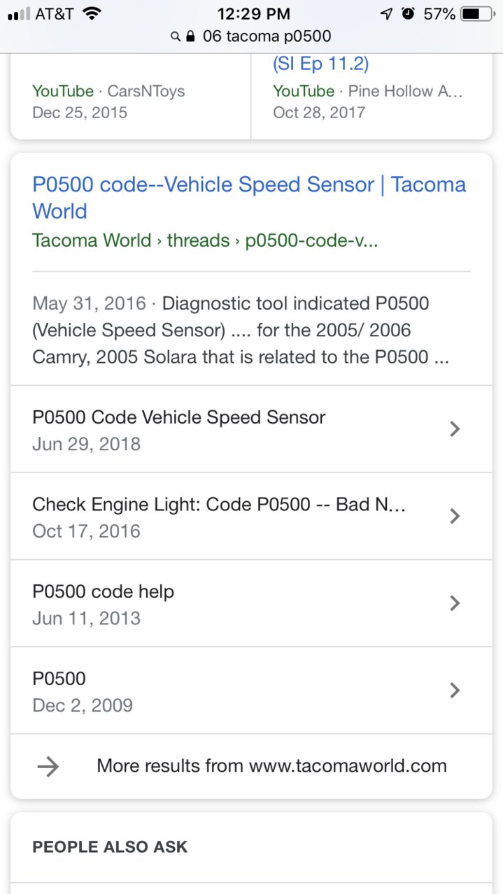

    Plugged in scanner and getting p0500 code.

    7BDEF9DA-14F7-451C-A818-BC1BFE6C3CE5.jpg That appears to be the speed sensor. Check your connections and make sure nothing was damaged when you replaced your springs

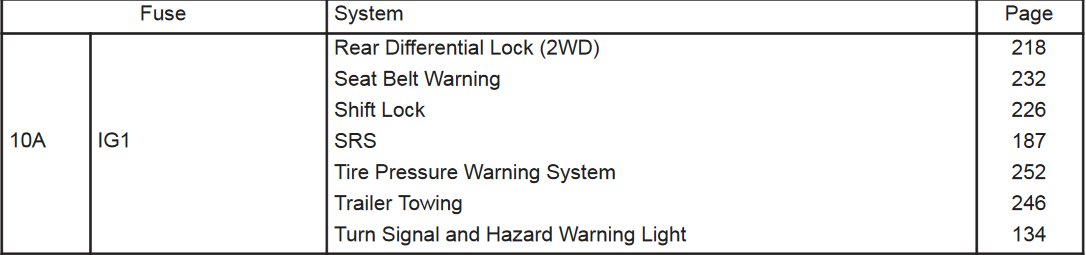

    I think you mean IG1 Fuse... That supplies these items:

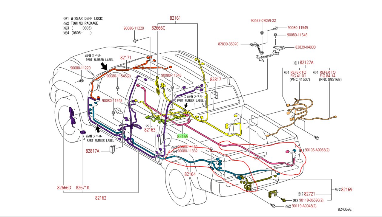

    It sounds like you have damaged a wire when doing the rear leaf springs. That is where I would start looking.
    Blowing that fuse when shifting into reverse would indicate a grounded hot wire to the reverse lights. And when the fuse blows you get a lot of other symptoms that are false alarms due to the blown fuse.
    Reverse lamp circuit:
    https://www.customtacos.com/tech.ol...toyewd/06toypdf/ewd/2006/tacoma/h/em01d11.pdf

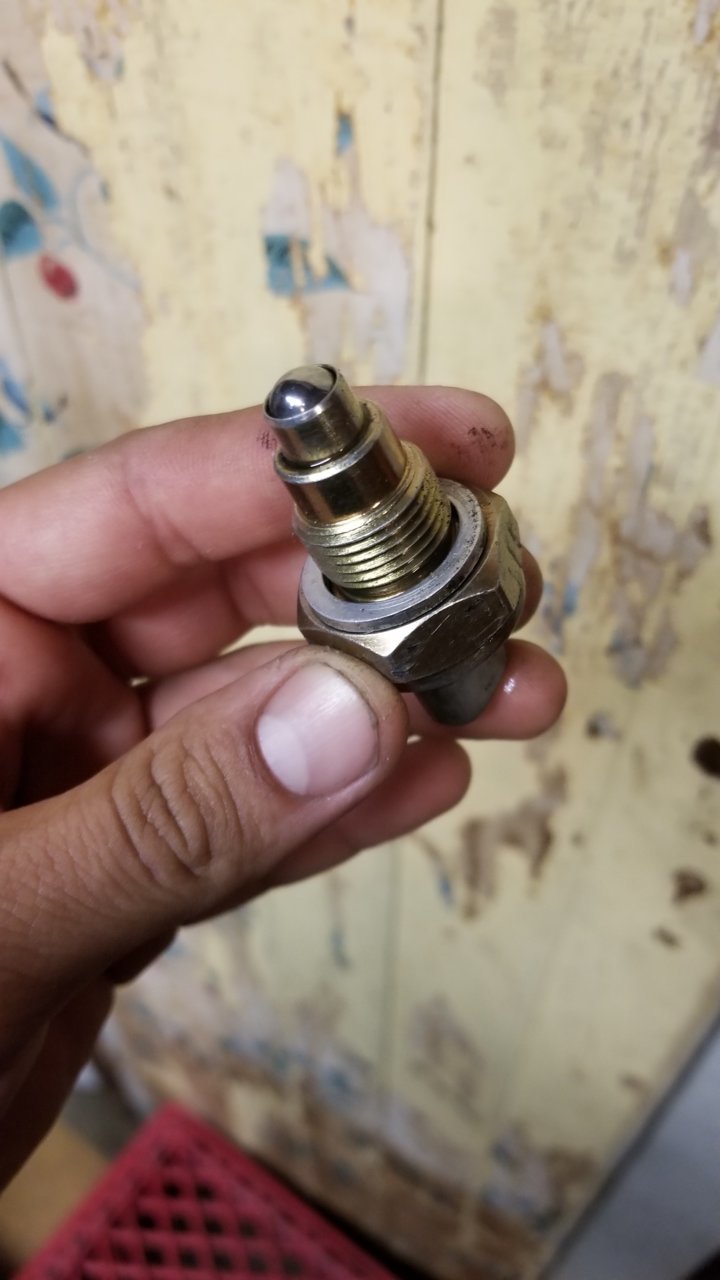

    Bad switch. Was grounded when activated. Happy it happened in my garage and not on my road trip I have planned in 2 weeks

    Manual transmission reverse lamp switch.

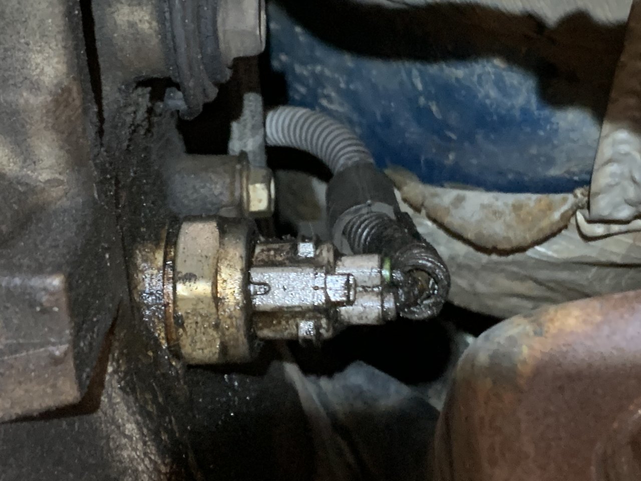

    Where is that switch located?
  15. Mar 23, 2021 at 8:01 AM
    b_r_o
    b_r_o Gnar doggy
    Nov 17, 2016
    #202672
    14,279
    Alex
    WA
    2015 DCLB
    On the side of the trans

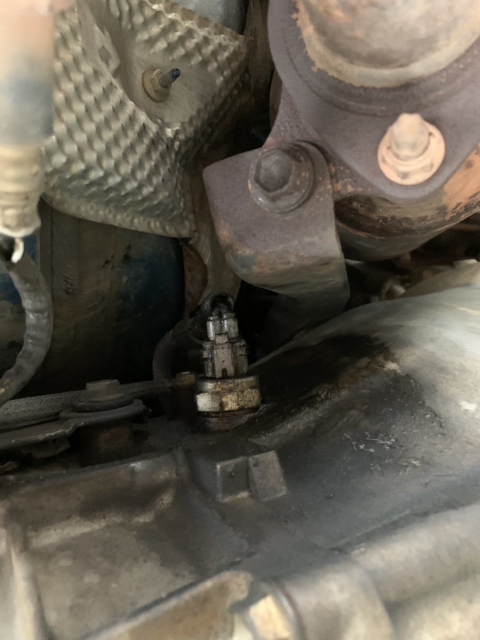

    If think this is it. It’s oily and the wires look exposed. 697D2EA9-8E4F-46F7-ACDC-36E2F74F6F05.jpg6A78C273-B881-4C2F-BF84-A16B1A3B3896.jpg

    Update: my problem is in the reverse switch. I plugged it, and everything else is working, but the backup lights. Will be getting a new switch.
