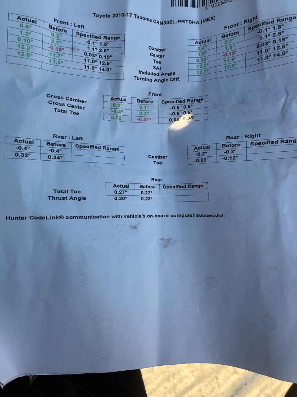

    Well hopefully this is better than it was. I only drove it about 5 miles to my work so I couldn't tell much of a handling difference. I'm going to keep a close eye on the tire wear and get new UCAs if it still bugs me.

    I'd say the second alignment is great for factory UCA's. I'd be happy with those numbers.

    After driving home I can tell it handles better. Before it felt like only half the tire was contacting the road, almost like it was dancing around. Now it feels much better, more effort to turn the wheel (in a good way) or like I can feel the road. Also I may be making this up but, I swear I hear more road noise out of my tires which doesn't bother me.
