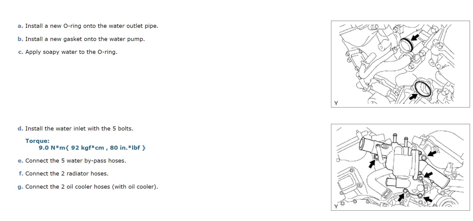

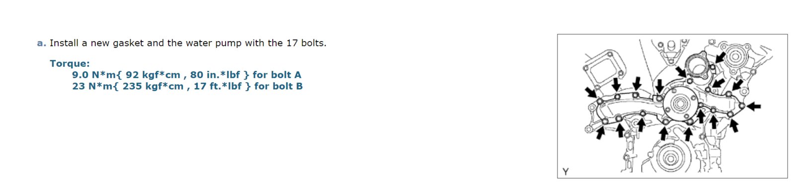

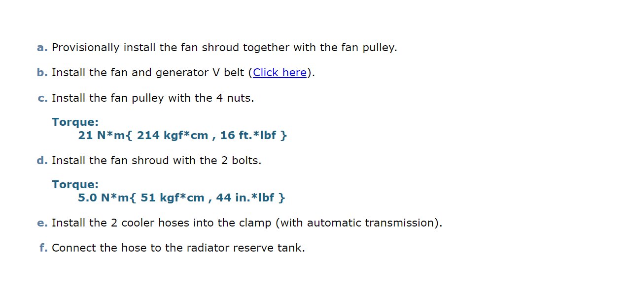

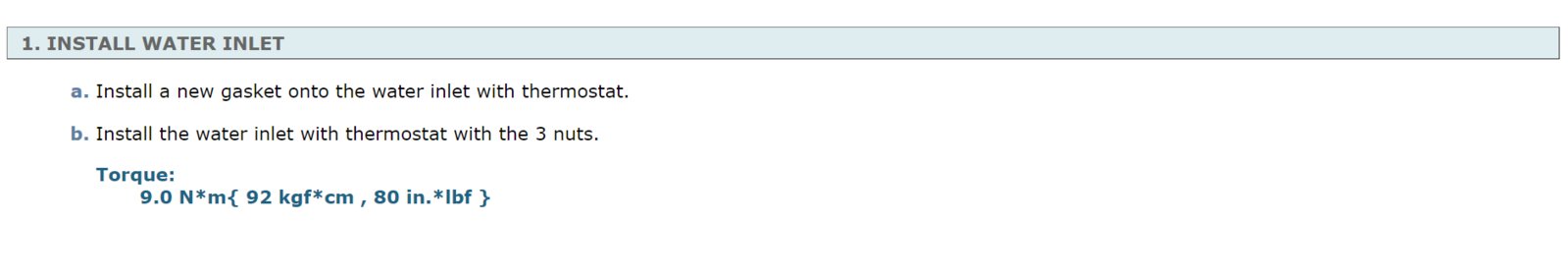

    It's pretty straight forward. Just a mess like any job that involves the cooling system.
    Drain the coolant, Remove the Belt, Fan, Alternator, T-stat housing and Idler Pulleys.
    Bolts A and B are big/little.
    A = Little bolts
    B = Big Bolts
    Thermostat

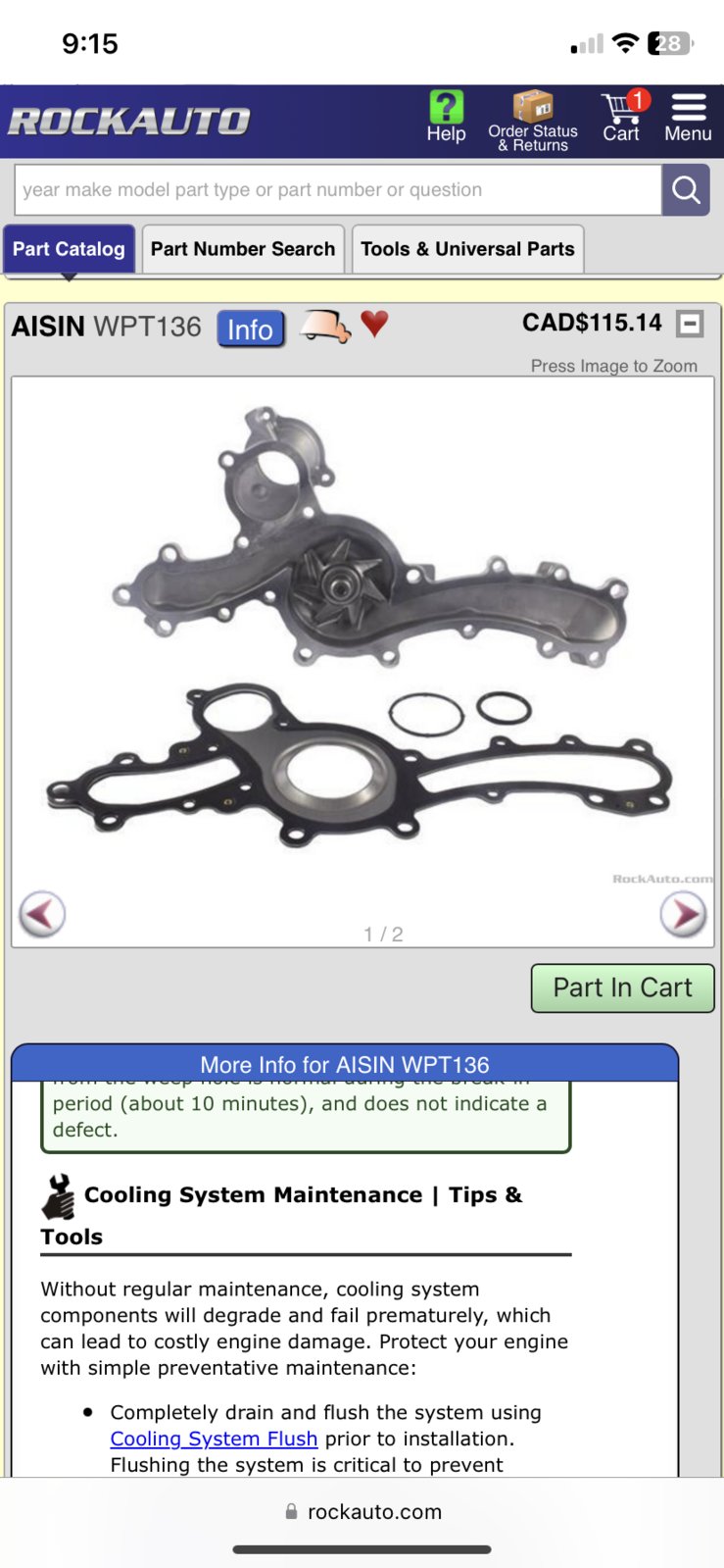

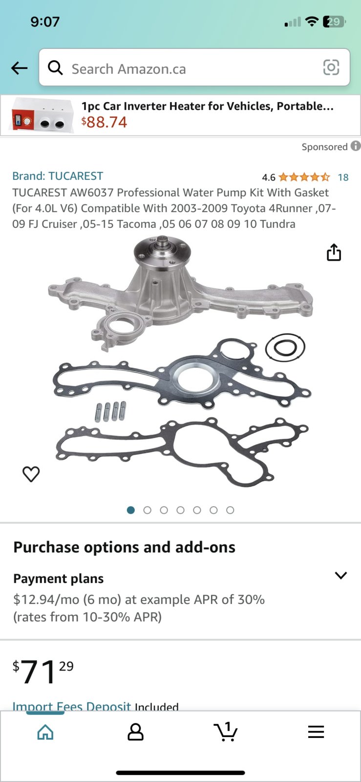

    you know exactly what model for the 4.0L 2006 engine? there’s so many models when i search it up
  11. Apr 2, 2024 at 6:07 PM
    mark06yoda
    mark06yoda [OP] Well-Known Member
    Dec 12, 2023
    #439394
    161
    marcus
    2006 Black Tacoma TRD Sport DCSB MT
    71.99??

    Go with the Aisin from Rockauto. The WPT 136 looks to be the correct one
    TnShooter and Dm93 like this.
