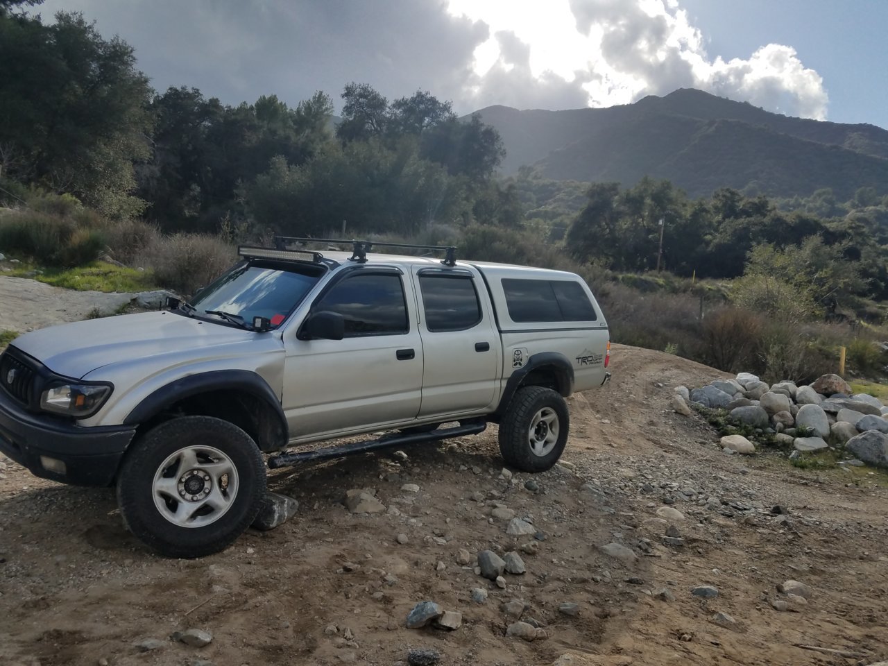

    It happened to me this weekend on the trail. It sucks man change em before it's to late everyone! Lol 20180324_162224.jpg

    Anyone know what can be the issue. My ball joint failed on me this Saturday. I replaced it on the trail yesterday. But today when I drove it it locked up mid turn. I almost drove onto the sidewalk. The only notable thing that broke was the CV and LBJ. Steering fluid seems fine. Sorry if I'm thread stealing.

    damn, that sucks dude...sorry to hear. When you replaced it on the trail, did you use a torque wrench on the 4 LBJ bolts (60ft/lbs) and blue locktite? Was it the ball joint itself that gave out or the bolts?

    It was the bolts that broke off. I Just put the bolts in on the trail as tight as I could get them to make it home. I installed everything today new CV and new LBJ

    Huh, weird that they broke...60 ft./lbs isn't hard to do by hand I don't think. I wonder if the bolts that were included with the LBJs that you installed on the trail were not grade 8, if they were cheap bolts then makes sense that they would break. What kind of LBJ assembly was it, OEM, Moog, ?

    It was an auto zone brand. But I noticed that one bolt was shorter than the rest I think it did not thread good in the spindle. I bought longer ones for the 2 that go closest to the disk.

    The bolts are specific to each side of the assembly, one side has longer bolts than the other...if they were switched around that could very well cause failure

    Bolts shank out, when this happens they shear off. Thus the warning of what bolts go where. They also stretch so putting a bolt to tq the 2nd time doesn't make it the same overall length as the 1st time

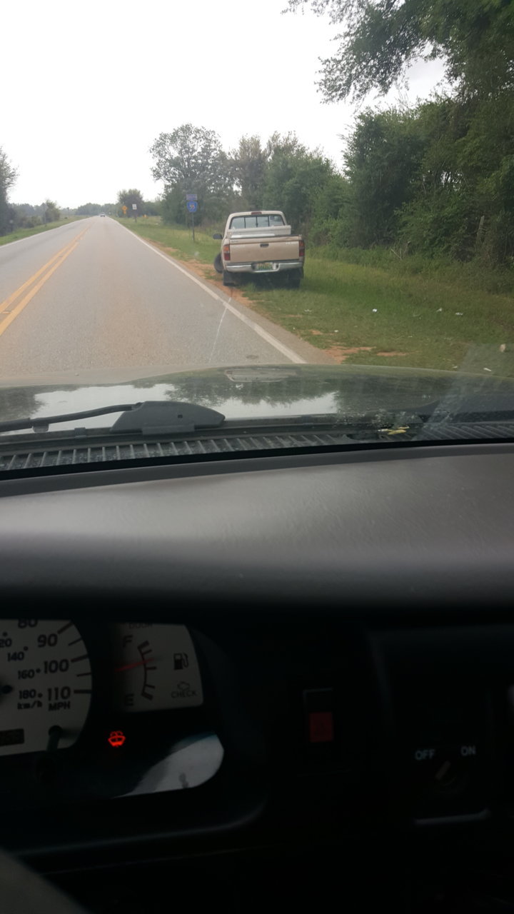

    Drove by this on way home from work today..
    OneWheelPeel likes this.
  19. Mar 29, 2018 at 4:38 PM
    #59
    Taco302
    Taco302 Well-Known Member
    Jun 10, 2013
    #105981
    763
    Greenbow, Alabama
    2003 2.7L 5 spd 4x4 xtracab
    And its not the first ive seen on an all stock tacoma with no lift.
