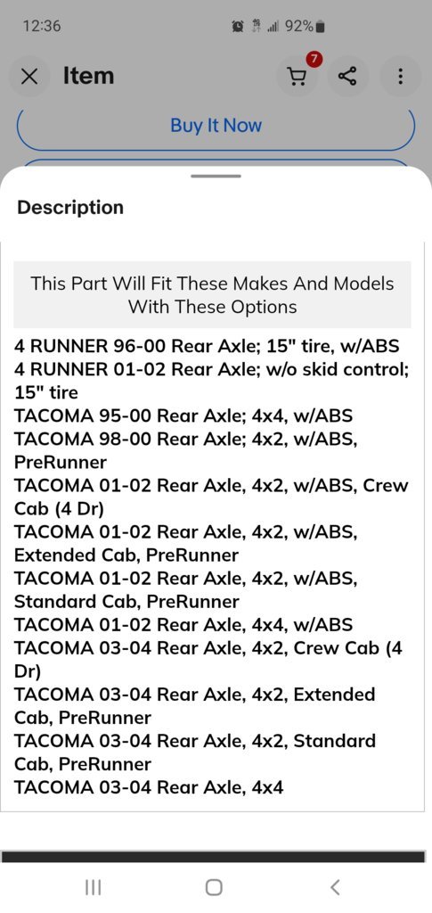

    Would anybody trust a repop axle from ebay purchsed for $227? Id rather stick to oem but im having an interesting time of it.
    Found somebodys alleged interchange list. Curious if anybody can confirm or deny accuracy.
    The nearest junkyard axle on car-part.com is from a 97 4runner 4x4 abs rwd. By the alleged list it should work.... is there anything im missing?
    Thanks

    As far as the axle shafts are concerned, you should stick to a 6 lug that matches your diff (open 8.4", locked 8") and abs (with or without). I am not sure if the axle shafts between the 8.4" and 8" are different or not, but the ones without abs might not be machined to accept the tone ring.

    Unfortunately my truck is non abs but has abs axles with tone rings in the stackup and necessary for proper seal engagement. Has factory toyota branded plugs in the abs sensor holes. Must have been a dealer installed option that year.
