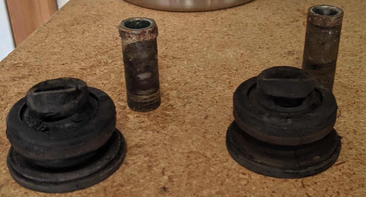

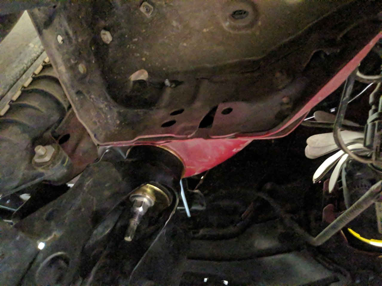

    Yes. The LF mount between the frame and chassis holes were severely off. Removing the bolt spacer and rubber you could see that even with new components the misalignment would quickly wear out the rubber and the spacer would again rub through causing the creek noise. I got under there with a tapered reamer and made the spaces line up. No more issues. Do the same...IMG_5741.jpg

    I trimmed mine too to make the misalignment not smash the rubber gromit. The super lube makes it hard to see but it has clearance now.

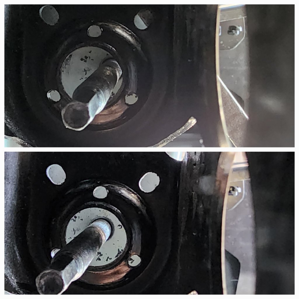

    Finally got my Mounts fixed. Top picture is before and second is after they aligned the mount.
  20. Apr 30, 2025 at 6:15 AM
    #20
    ArmoredTaco
    ArmoredTaco Member
    Jan 25, 2020
    #317208
    10
    MS.
    2010 Tacoma TRD Sport PreRunner LB / 2021 Tacoma TRD Off-Road 4X4 SB
    How did they fix it. Cut it off and re-weld the mount? Looks like a good fix.
