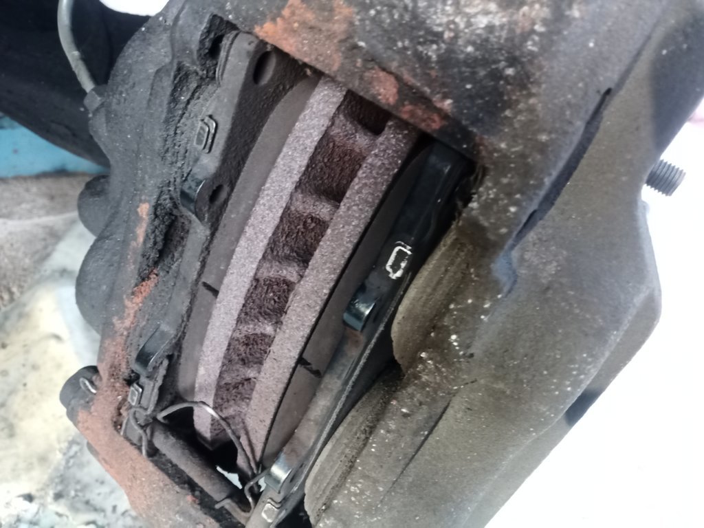

    #39
    Black97v6MT
    Black97v6MT 365k on the 0D0 ... 5VZFE R150F 4WD
    May 9, 2024
    #449422
    1,245
    iMA0
    tacoLand USA
    28 years of livin' Gen1 TacoLife...
    i will add to that there
    a missing pin
    this was found by i over 2 years after the Toyota dealershop did a brake pad service on my relative '11 reg cab
    hopefully not All dealer would be this incompetent but this one sure done did
    symptoms that led me to dig in there one full day to replace both rotors at 80k miles (possible warpage)
    shimmy in the steering on low-speed stopping
    pounding sensation upon hard braking coming off the freeway at high speeds
    NASTY chatter and pounding in the ABS on winter slicked frozen slop
