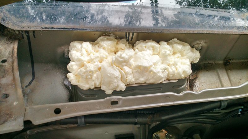

    There's allot of old beat up jalopies and high performance nuts running around my side of town. They have done allot of shade tree work on their old cars. There's no emission inspection stations here in Florida. Today's cars are built to draw in a small amount of fresh air in all the time, whether or not you have the vent completely closed. I got fed up and made a permanent fix. Just wonder why they didn't put a cover on it or roof, instead a box with no top?

    Be Careful stuffing air intakes that are supposed to be open with foam. Not sure about current tech, but cars back in the day were designed to have positive cab ventilation to prevent fumes from building up in the cab and killing you.

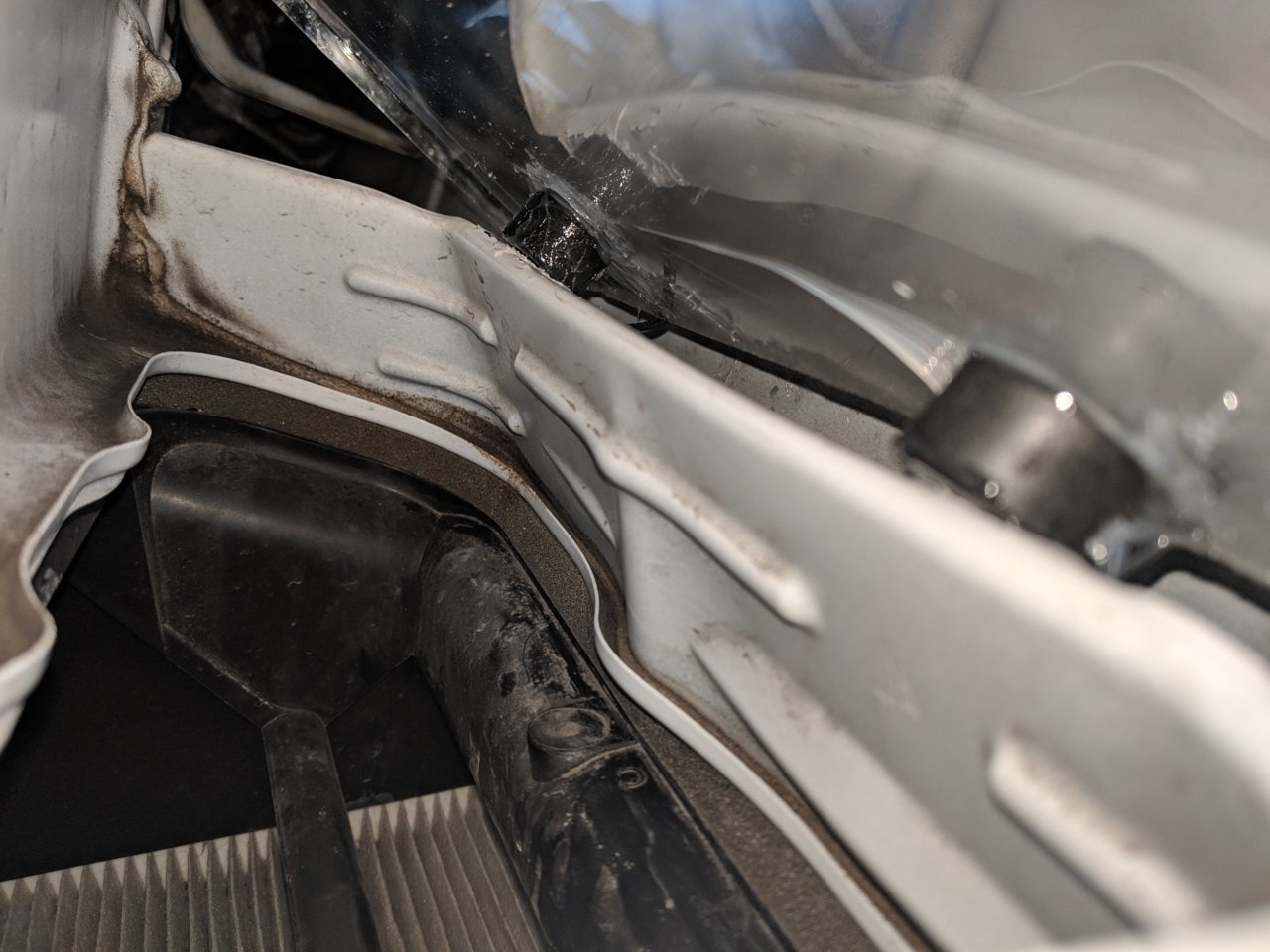

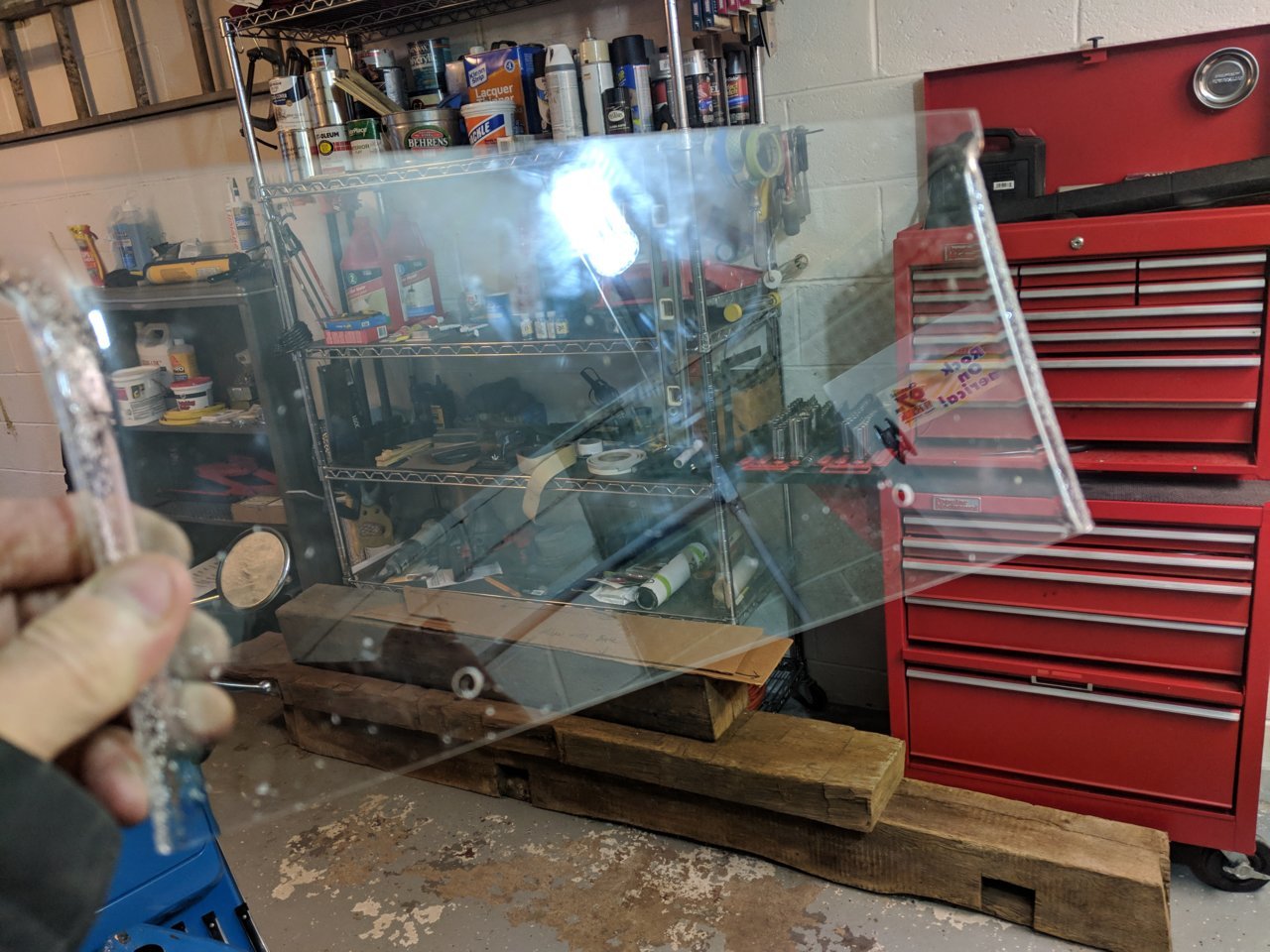

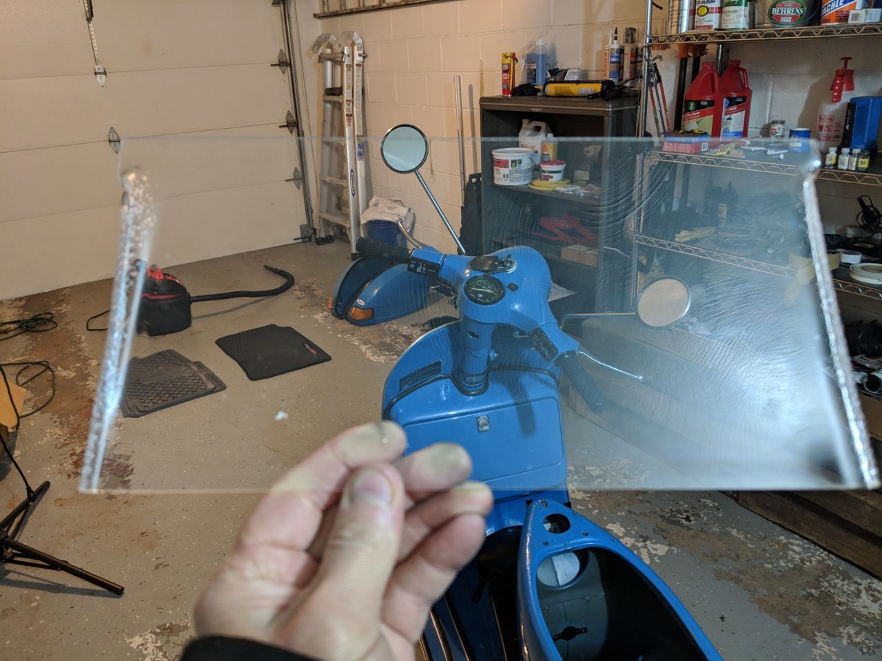

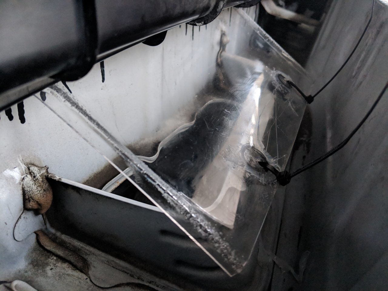

    Thanks for all the help. I used a piece of lexan about 5.75 x 12" which could have been 14" but it's all I had so I actually torched the edge and bent down drip edges. I also used a couple of spacers to allow more air flow and put 100% silicone all over them and the edge that goes against the cab hopefully to keep any vibration/wind noise at bay. I also bent the tab with holes in it on an angle with my thumb. I didn't remove the cowl, just lifted the one side and it was not a problem.
