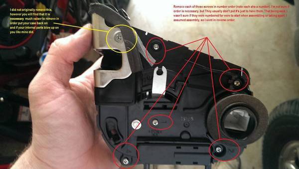

    Okay, got mine done last night, we'll see how long it stays. I couldn't get the damn motor apart to clean the posts. So I figured, I can't hurt anything so I sprayed a very small amount of break cleaner in the openings of the plastic end, then used compressed air to blow dry it. (I figured worst that could happen is it still doesn't work, or blow shit up which would be kind of cool)
    I took a few pics of the steps that I'll do a small right up on, but most importantly I wanted to post a pic of the actuator just in case you do what I did. Mine fell apart and I took a while to figure out the way it goes together since none of the pics I saw on here were of our actual actuator (at least not the rear drivers side).
    I'll update in a few months to see how well it holds up; I know a lot of you report it works for a bit.

    So if you've got them out. I still haven't done a full write up but here is a quick and dirty (of just the actuators):
    I used break cleaner, I know another person on here used electrical parts cleaner. When spraying, I did the smallest spray/burst I could possibly do. Then in the same openings I sprayed a can of compressed air.
    Reassemble.
    Let me know if you have any questions, good luck.

    Crap, I just saw all of my wonderful text is too small. Son of a bitch. If you can't blow them up, let me know and I can re-write or explain what they say.
