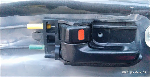

    I have a question for you or anybody else that can answer.
    It appears my cable for the inside door lock switch has detached from the actuator. I can manually flip the lock switch pictured below, but it does nothing to the lock anymore.
    Here are my questions:
    1. How do I remove the inside door handle pictured below?
    2. Where are the best step-by-step instructions for removing the actuator from the door?
    My door interior has already been removed, I just need help the inside door handle and actuator removal.
    Thanks.

    Just to clarify, when you manually flip the orange lock witch above, the door does not lock?
    Unless you have messed around with the lock and taken it apart before, I think it is highly unlikely that the cable is no longer connected in the actuator. When you lock the door manually, can you see the yellow cable moving?

    Welp. The door lock switch (the orange lock) still moves the yellow cable back and forth as it should, but it doesn't do anything anymore to the actual lock in the door. The cable is still secured to the the actuator case, which of course I can't open while in the door and now must remove the whole assembly.
    Noted. Thanks. I read the Rav4 forum writeup on removing the locking rod and actuator. So I should be in good shape to replace now.

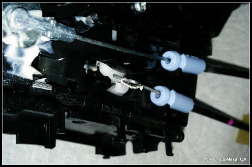

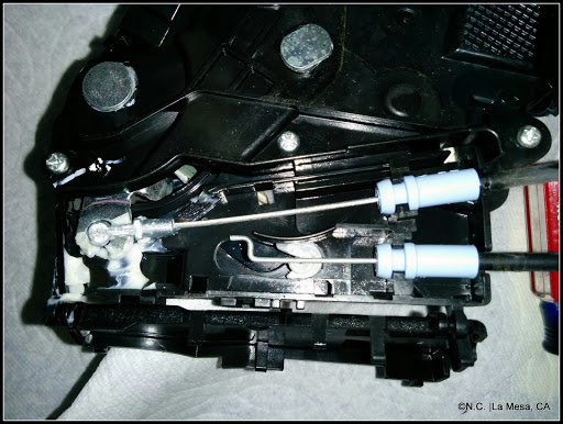

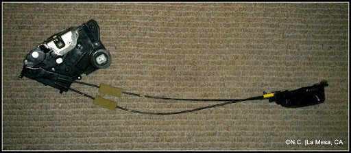

    I fixed mine yesterday. Here are some pics to help the next poor soul with a broken door lock switch.
    Here it is all removed from the door.
    Swing open hinged service door, the cable on the bottom is not attached and needs to reattach to restore manual door lock switch.
    Solution: Wire wrapped cable to white plastic.
    Close hinged service door, and test manual lock switch. Test confirmed good. Reinstall the whole assembly into door.
