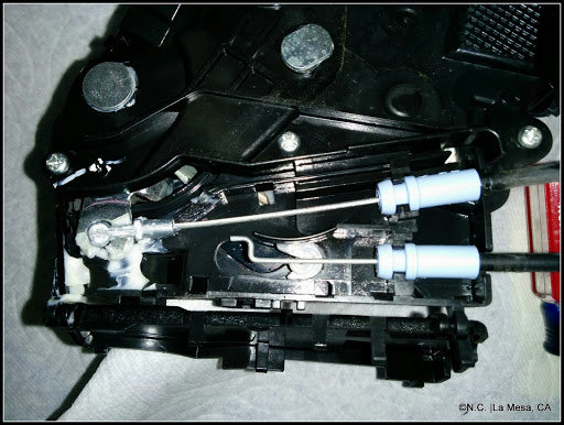

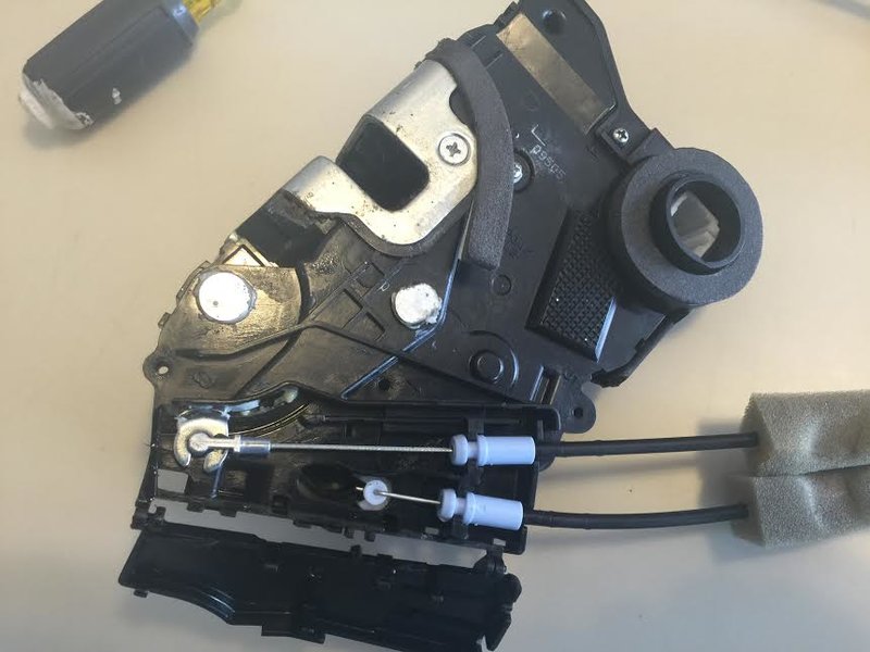

    I was in a hurry to fix, and it was the best I could come up with in the 30 minute time space I had to remove, repair, and reinstall.
    Comparing my photo to the good one below, it appears a white circular piece of plastic was missing from mine. I shook the actuator, but nothing came out... Not sure where it went. lol :D
    Mine
    Good

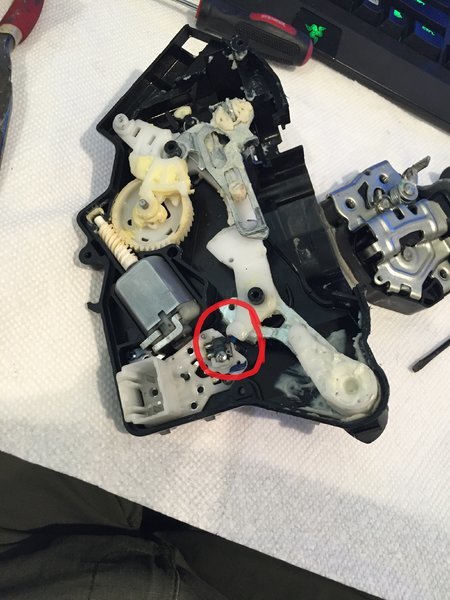

    I had the same problem, the problem is inside the actuator. There is a very small think piece of metal holding back a black push up switch. the metal slips down and then does not hold the switch back so the truck thinks the truck thinks your lock is locked all the time even when there open. i have attached two pictures. Good luck guys
