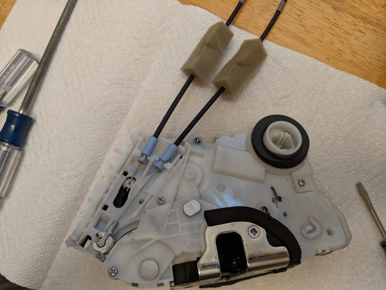

    I just replaced all four motors in my '14 and took a bunch of pictures in case mine came apart (the pictures below are of the front passenger side but they are basically identical to the driver's side). I was worried that some of the pieces may have moved out of place, but if you look at the pieces that have grease you can see where the pieces should go and cycle the latch before you clamp the top back on. Now I have four functioning door locks with one small issue. When I lock the truck with the key fob, the doors lock and then try to lock again only with the fob. In another thread it was pointed out that I likely have an issue with one of the detection switches (small switch attached to the plastic piece with the motors and where the harness plugs into the actuator on both the driver and passenger side). Hope this helps. I've gotten a lot of good info and pics from these posts.IMG_20181230_164545.jpg IMG_20181230_165548.jpg IMG_20181230_165557.jpg

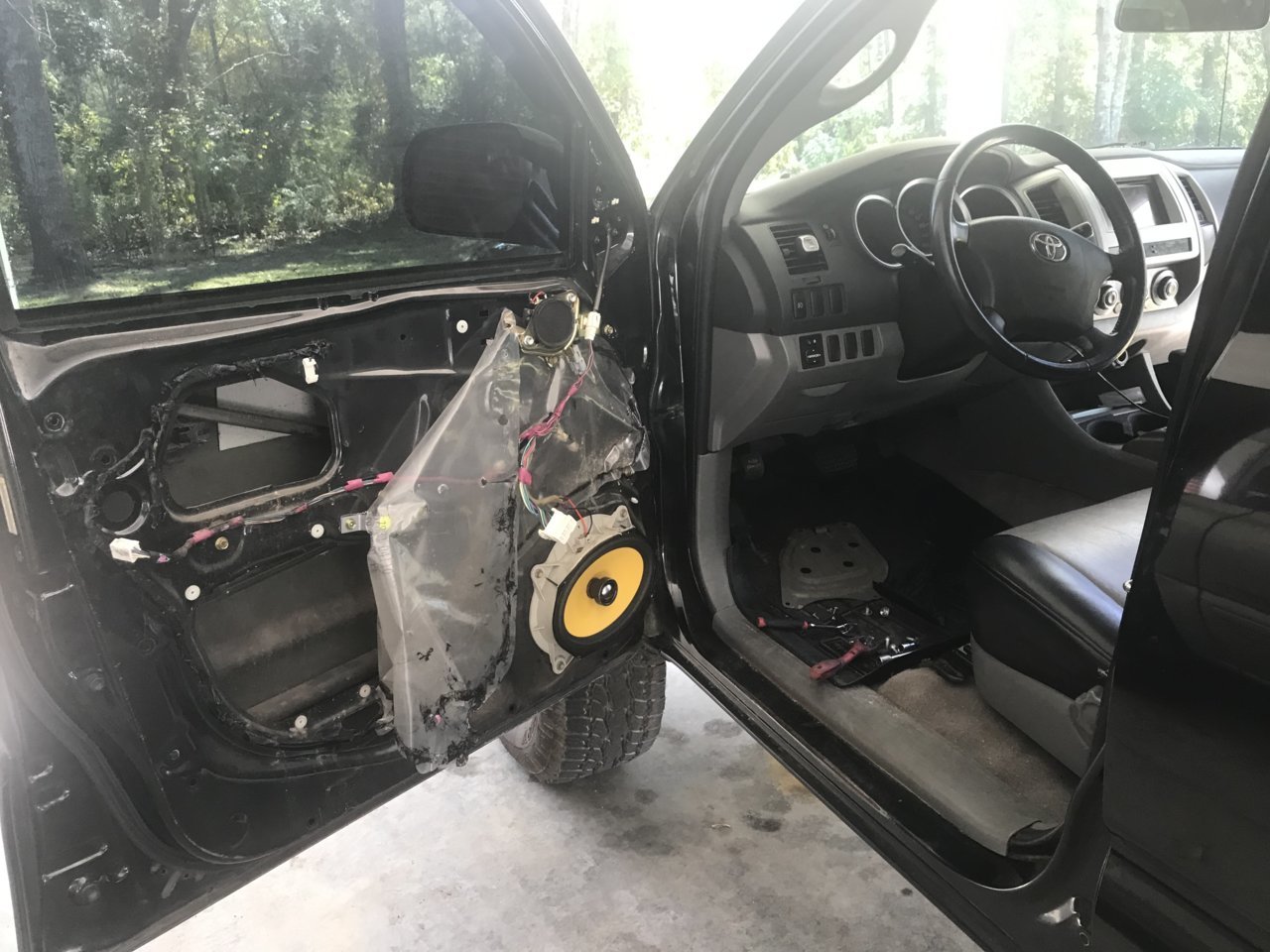

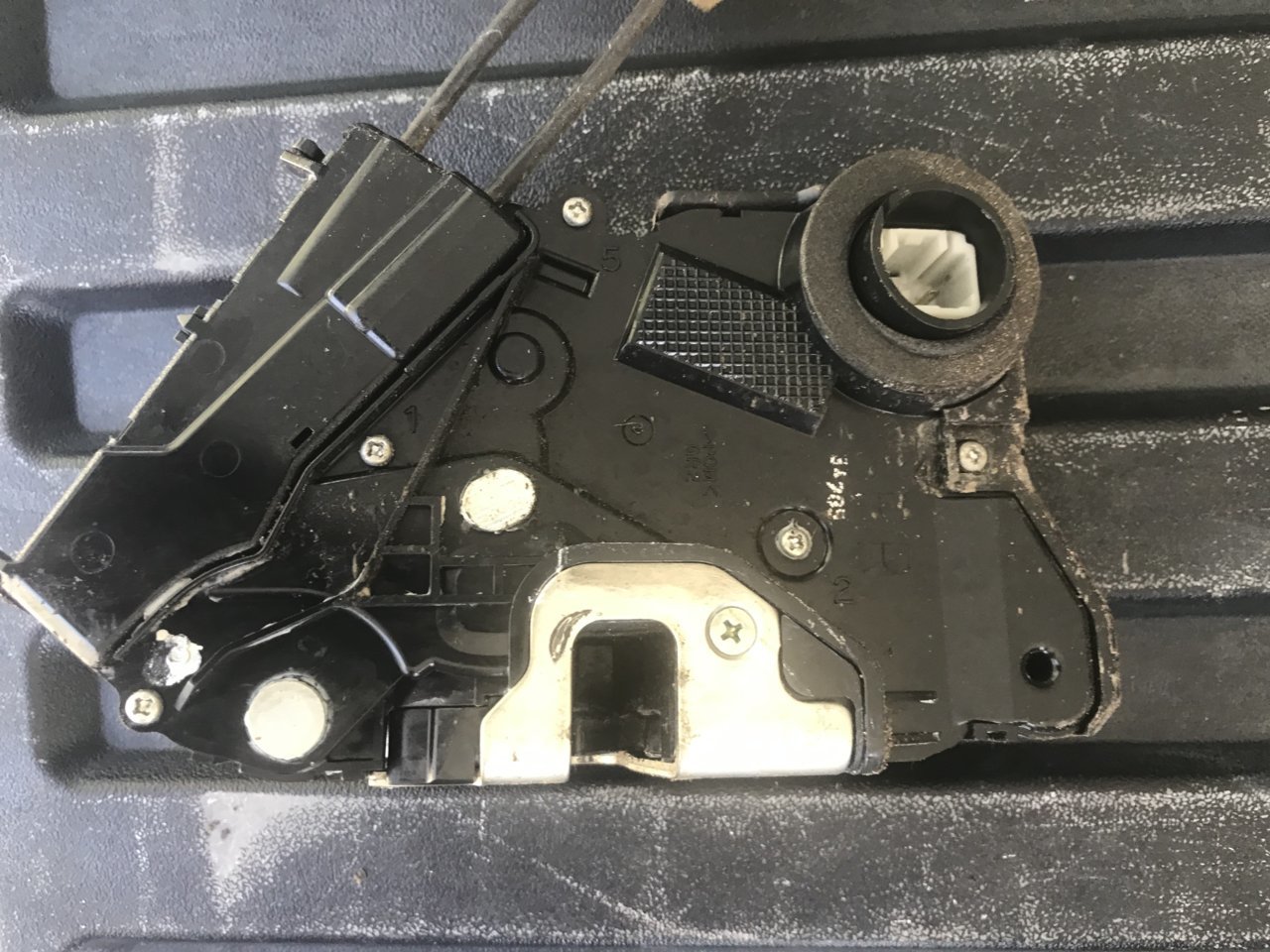

    Finally broke down and replaced mine today. Both front doors actuators were not working. Hour and half and reviewing this post a few times and we were done. Thanks everyone. A90B70C5-0EF3-403D-B772-571BBF3B75B9.jpgEF7FFFFE-0EBA-4C3E-8F27-11CA29E49095.jpg

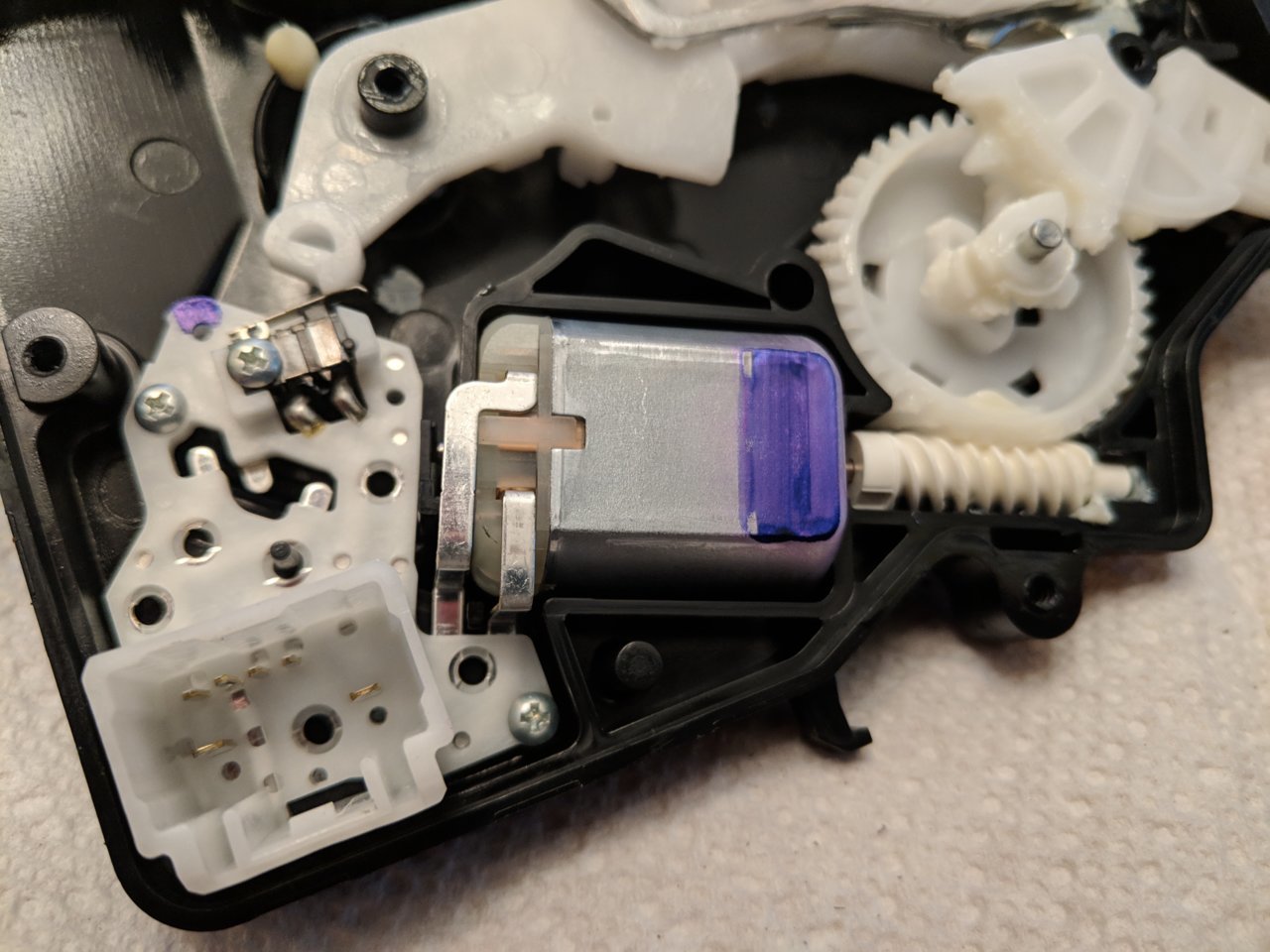

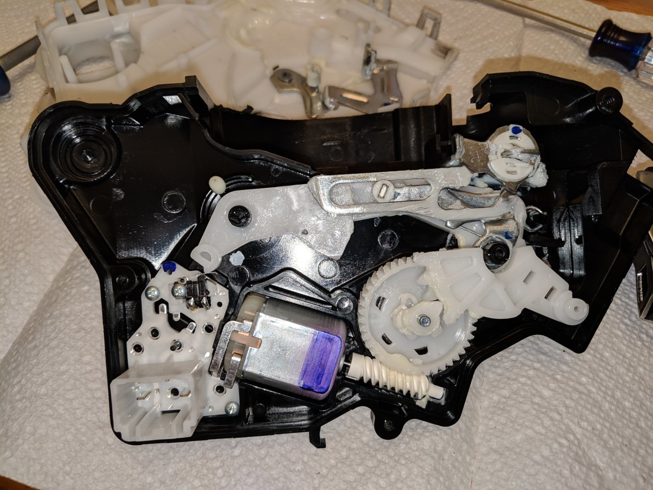

    I rarely post anything here, but I really needed to give thanks to those of you in this thread, especially those who posted pictures of the inside of the actuator.
    Mine went bad quite a long time ago, finally got around to doing it and although I knocked several pieces out, those pictures helped me get it back together and thankfully in 100% working order. Thank you gentlemen!

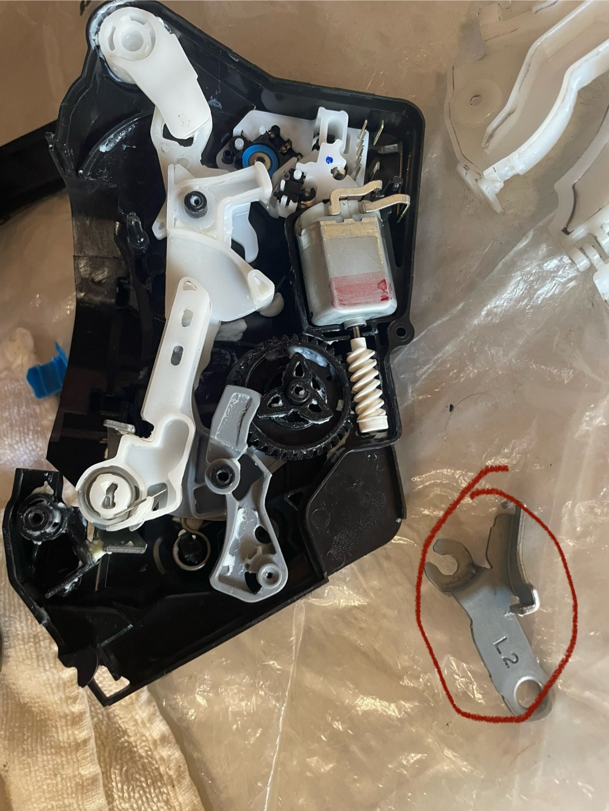

    hi everyone working on putting this actuator back together for a 2017 TRD Sport. Can someone please share pictures of how to finish the reassembling. Any guidance is appreciated. Thanks
