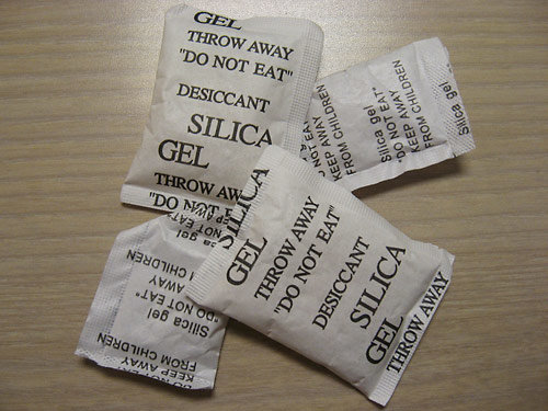

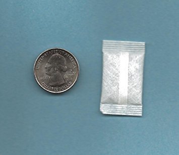

    Easy fix. Tie a string to one of these54c9747317a53_-_silica_packet_0410-lg.jpgdrop it in a turn signal bulb opening. Put the turn signal back in. Leave it for a few days it will absorb all the moister then when its clear. Take the bulb out, pull the string gently to remove the packet and presto your done.
    No need to make a thread like this for that. That could of happen during shipping with freezing temperatures and climate control buildings moisture could have found its way in.

    Certainly a good idea - but getting them in/out of the housing without tearing the bags and spilling hundreds of the little silica balls everywhere is likely to prove SUPER tough.
    Warm circulating air almost always seems best - in our experience.

    Ahhh yes - the 'lil packets make more sense - the other picture had us worried as they looked too large for sure.
    Still seems very tedious if there's an unfortunate amount of moisture - but definitely an option to add onto the list.
    Thanks for sharing the smaller size packet vs quarter pic :)

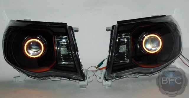

    I understand what you're saying. Fair enough. I guess I'm the kind of guy who would rather just do it right the 1st time. Nothing frustrates me more than having to do any job twice. Nonetheless, there are many jobs I have done twice, for ignorance on how to do it right the 1st time.
    I'll take a heating gun to the housing; slowly heat it up; get the moisture out and the re-seal it. And hopefully, all will be fine. I'm sure it will.
    But, to be honest, I hope that BFC has changed their process for re-sealing these headlight housings. I'm not sure exactly what to do differently, but I know if I ran a business, no way I'd seal another housing the same way I sealed these.
    I have used the black sticky stuff TRS (Retrofit Source) sells, and I've personally had good luck with that stuff. These are my 2nd retrofits. 1st time I went DIY with Morimoto mini's but decided to go with a different projector, so I went with BFC. To be fair, overall, the housings were BEAUTIFUL when I 1st got them. My only issue has been the seal. I suppose that seal may have failed anyway, even without the retrofit.
    So, to end on a positive note: here are pictures when they were new and beautiful. :
