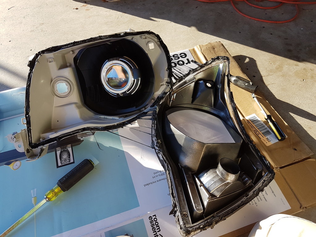

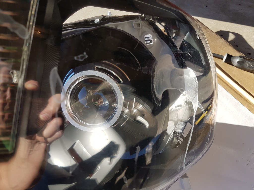

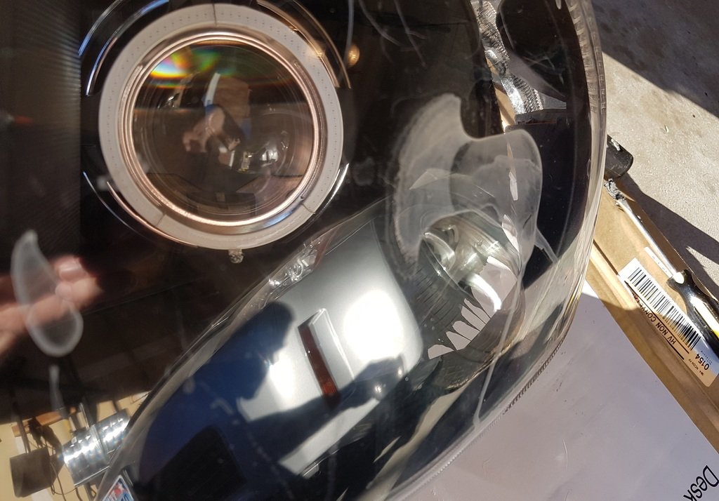

    Update:
    I was able to use a heat gun to make the moisture evaporate; however, the moisture would come right back after 1 cold night. So, even though it would appear that the lens was completely clear, the water was still inside the housing somewhere ready to form condensation once more.
    Also, the condensation left water marks:
    So, the only real solution was going to be to re-open the headlight housing. Not a problem -- opened very easy. I only heated it to around 170 degrees in the oven for maybe 30 minutes. That softened the butyl enough to make separation of the 2 halves pretty easy. Recommend removal of all bulbs, rubber U-joints and rubber back seal prior to heating in oven.
    Once separated you can get access to the inside of the clear lens and go to work with glass cleaner and lint-free cloth.
    Recommend re-seal with butyl rubber, as available here from TRS here: https://www.theretrofitsource.com/accessories/build-materials.html

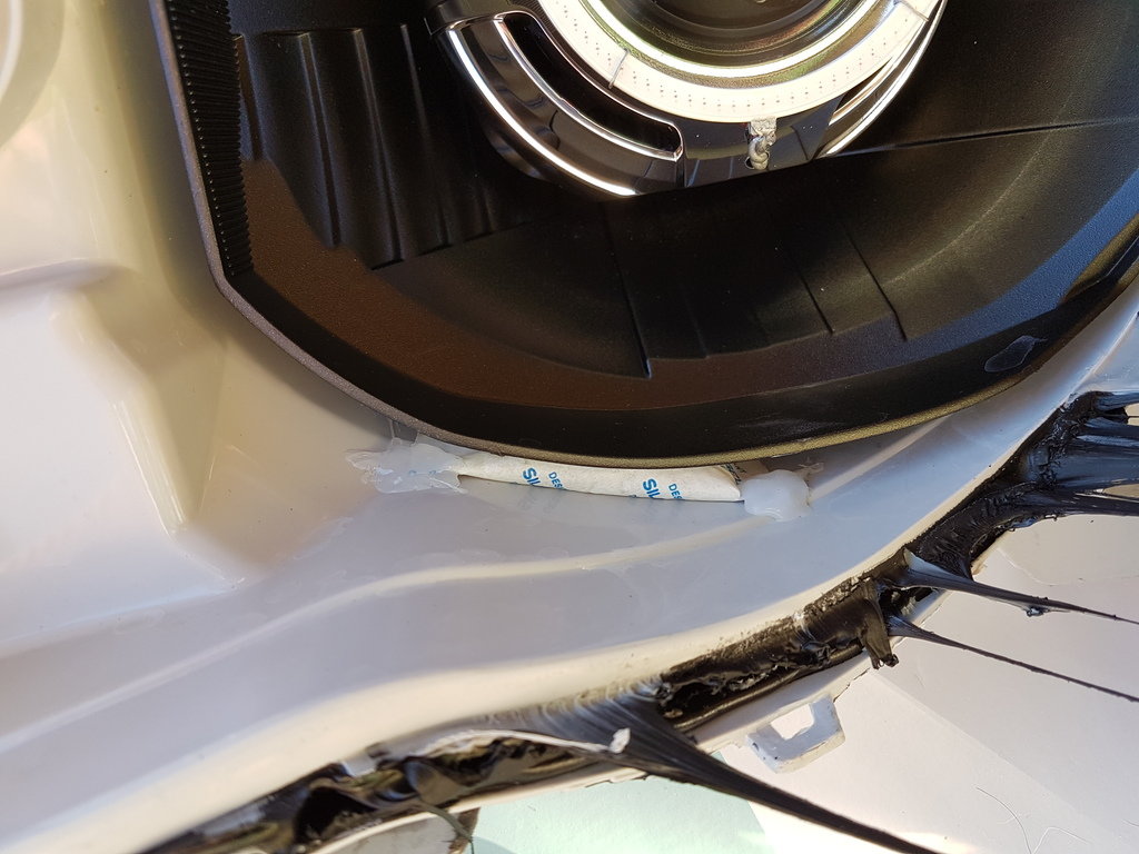

    Also, I found the source of that rattle from day 1:

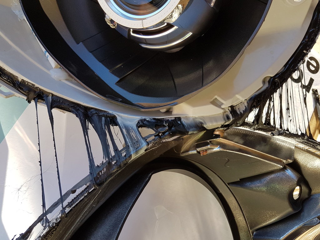

    Look BFC. I took the housing apart, and when I did it was CLEAR to me how the seal failed. The "bead" of butyl was inadequate at the seal line at the top. Most of it rolled toward the inside and didn't fall into the valley where the 2 halves meet. No wonder it failed.

    Nothing in the picture shows what you're describing though. Seems as if the entire channel has an even additional layer of black butyl - like it did when we originally built the light - nothing rolled over toward the inside.
    You're entitled to your opinion though - we'll never deny that.

    Bottom line . . . the RTV silicone did nothing to hurt the BFC butyl seal. Also, the BFC butyl seal failed. Granted, BFC offered to fix it. Great on them, as their website clearly indicates that the seal is only good for a 1 year warranty, and these headlights are 3 years out. So, YES, I agree, BFC is offering to fix something outside of their warranty. But that doesn't change the fact that the BFC seal FAILED, epically, I might add, at 3 years. No way anyone paying for a HID retrofit expects that kind of moisture at 3 years. No one would pay for a retrofit if this is the expected life of the seal.
    All of you can think what you want, but the truth is that the butyl seal, if done properly, should not have failed a 3 years. Also, fact: the RTV silicone smeared on top did nothing to hurt the butyl that should have been sealed inside.
