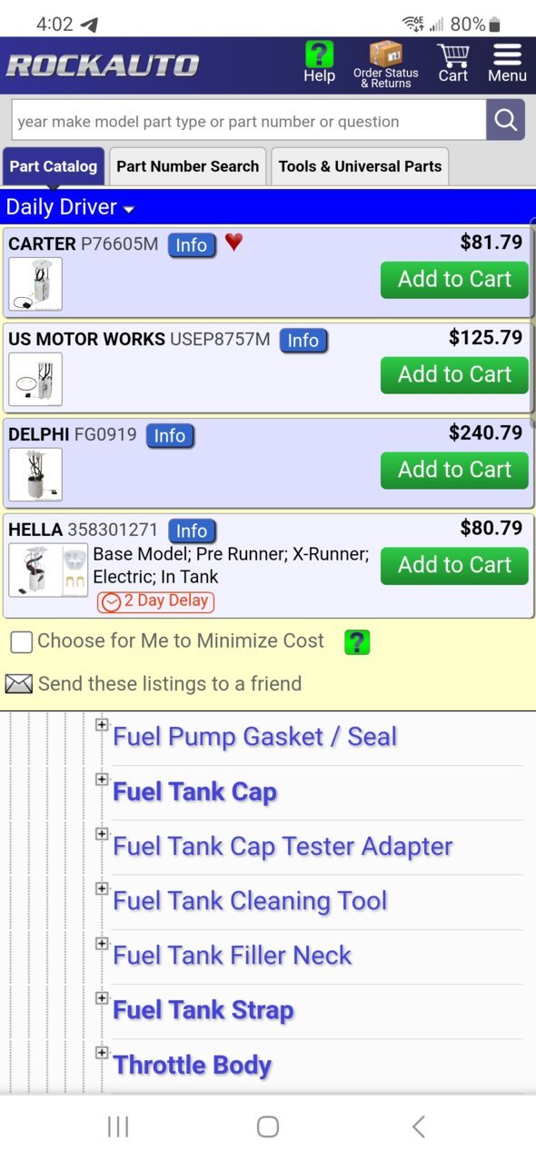

    Seems most likely that you need a new fuel pump/filter. Filter is highly saturated, and the pump is aged.
    The URD upgrade kit is cheap, and offers a changeable fuel filter.
    RockAuto has options. There is also OEM.

    I really like the replaceable filter, that will be very likely the way I go on this. Thanks.
