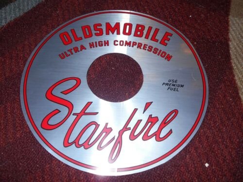

    Surprisingly it is -- 11.8 to 1. :eek:
    Through the magic of modern electronics they keep it from knocking on 87 octane.
    "Not your father's Oldsmobile" I guess. :laugh:
