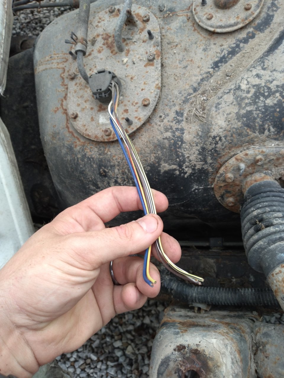

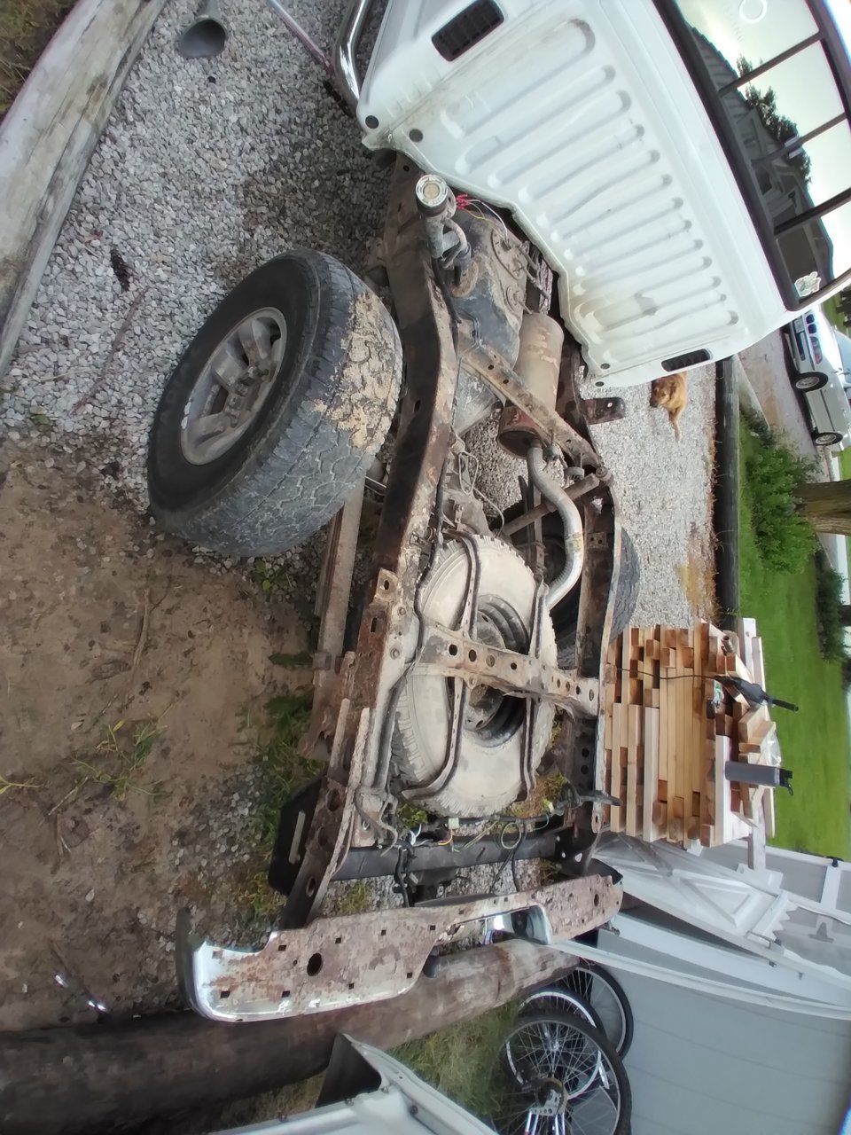

    Okay so. Heres the scoop. As previously stated i decided to take the entire goddamn bed off the truck. Glad I did. As shown in the photo, every damn wire from the harness leadkng tk the fuek pumo was sheered off. Not sure how this happened since the truck has literally been sitting for a month, but runs weekly. So I buttconnected all the wires back together, checked the plug for power and it checked out. Now the kicker. Still wont start and the fuel pump doesnt hum or run or anything.
    Is it possible ive been running it and driving it around without a fuel pump? I dont see how thats possible.
    I even did the jumper trick again to see if it was also a bad relay not running the pump now that it was wired, but no go.
    Im confused as hell. Somehow it was running with sheered wires and a bad pump. I dont get it at all. :confused:

    Not possible for a fuel injected engine to run without a fuel pump. These trucks only run the pump during cranking so it’s difficult to hear them run. Multiple weirdness going on here. Which came first, the cut wires or another problem entirely.

    They run the fuel pump during cranking to build up fuel pressure. They also run while the engine is running and some cars/trucks PWM or turn on/off the pump to control how much pressure is delivered to the injectors. I dont think Tacomas do this though.
    As for the cut wires, there's 3 electrical things inside the tank. The fuel pump, The sender for the Gauge, and the Low fuel Sensor for the light. I dont have the schematics handy but it's possible the fuel pump IS connected and what your holding is the wires for the other 2 things.

    I will look but there are no other wires going into the tank. This is it.
