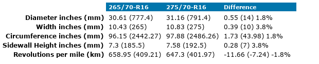

    I just drove mine from Virginia to Florida and got 18.3mpg. I was hoping for better. I have a K&N air filter, TRD exhuast, Tornado Fuel Saver, a tonueau cover, and am running 275/70/16's. Also had just changed the plugs/Oil, used BG 44k and had 36lbs of air in the tires. I figure my odometer is a little off with the bogger tires, but how much??

    meant bigger tires. they are michellin LTX M/S

    thats fine with what tires you have. even though I still get 20mpg with 255/85/16.
