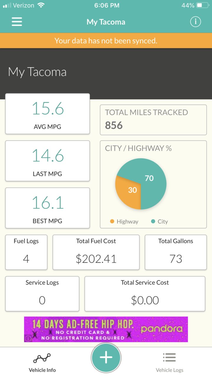

    Hello everyone I drive a 2013 2.7L auto 4-speed DCSB. I feel like I’m getting terrible mileage so I was hoping for some comparisons from others with the same engine and transmission. My last Fuelly fillup had me at 14.6mpg with an average of 15.6mpg over four fillups. I really try to keep a light foot and try and stay under 2k mpg.
    Is this just how it is with this engine and trans? Or is there something I should look into specifically? I thinking about cleaning MAF sensor and possibly doing an intake and fuel injection clean.

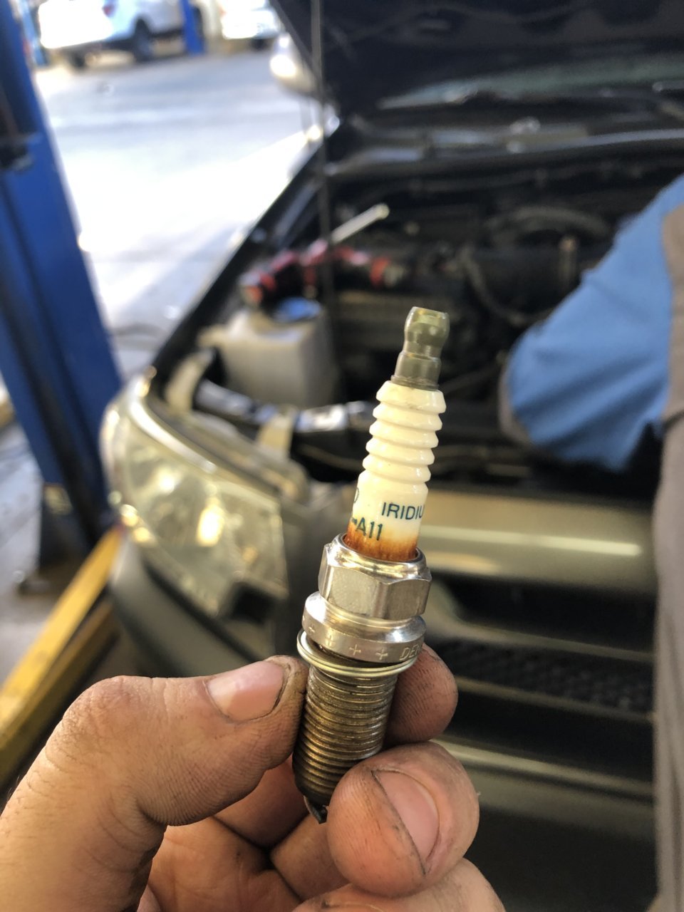

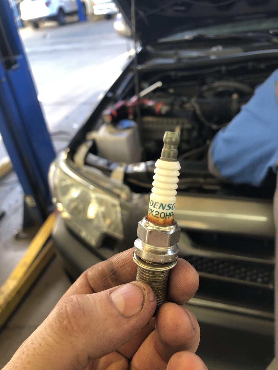

    7B08DABD-B844-4911-9570-BD35C1508B36.jpg EAEEF785-CA3B-4BDD-99D0-B1090F9299BA.jpg These are what’s in it so I’m guessing factory I don’t have time to look up part numbers just yet, cleaning up and going home for the day

    jup that's factory, they are rated in the owners manual at 120k miles in fact the one you have are the really good denso made in japan long life model, they have been superceded to SKHR11 model which may be a sub'd out version made elsewhere, you can still get those original A11'S you pulled at ROCKAUTO, the dealer sells you the SKHR11 for less money, both are IRIDIUMS req'd by Toyota to run in the 2.7l engine.

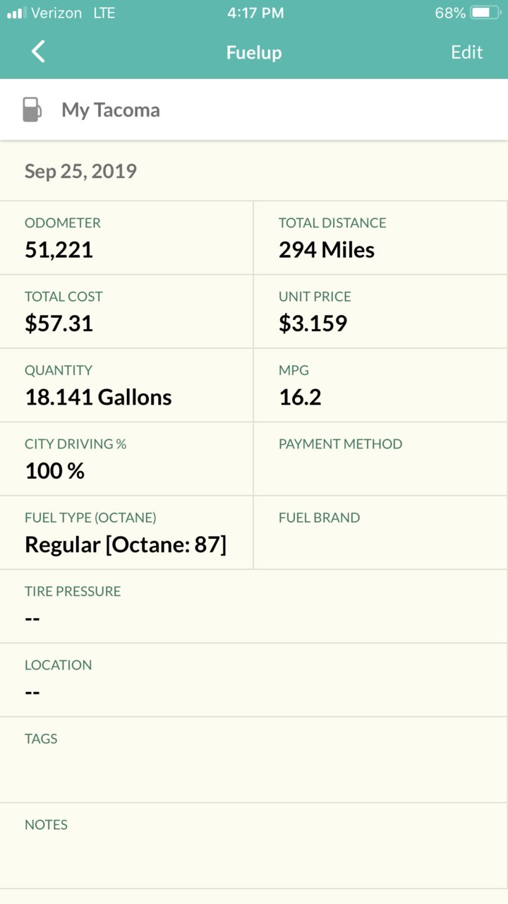

    So here’s some more fuelly results after this last tank. I was about halfway through the first quarter of the new tank when I replaced the engine air filter and there were some times where I had to get on it on surface streets. Everyone in Arizona does 10+ on any streets especially where it’s 45mph. I’m gonna drive as conservatively as possible this tank and see what that gets me.

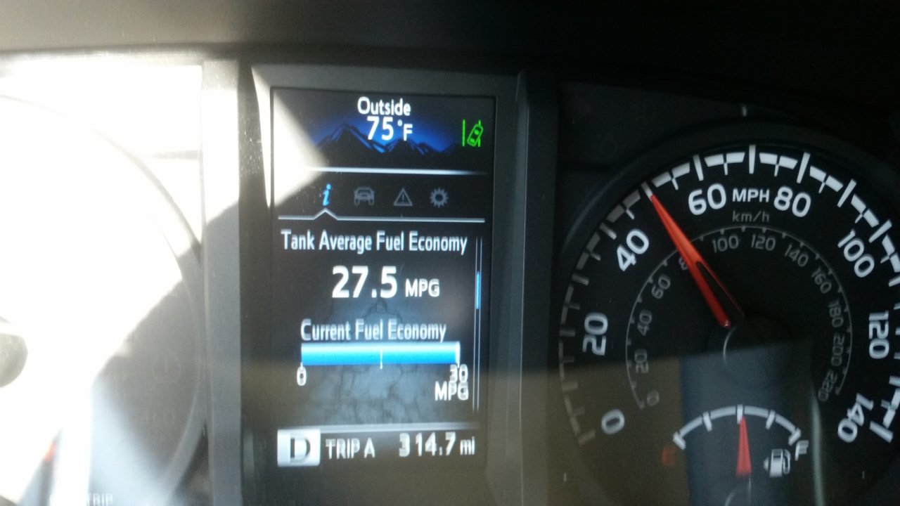

    My '14 4 cyl, 4wd only got below 20mpg once that I recall and that was when it was on dirt roads for several days during hunting season. Couldn't imagine 14 - 15 mpgs. Sounds like it may need investigating. Btw, my current 4 cyl, 2wd hasn't been below 25 mpg20190924_094635.jpg
