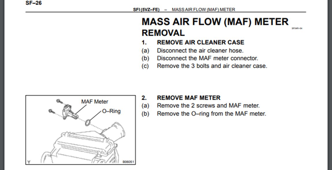

    MAF= mass air flow sensor. Its in the air intake tube between your air filter and the throttle body. It has a two wire connector coming off it.
    It senses how much air is entering and modulates the fuel volume. It has a tiny wire filament that can get dust and dirt on it and cause the resistance value to change, thereby giving the computer bad data.
    If you take it out (very easy to do), it is fragile. And, only spray clean it with MAF Sensor Cleaner. Do not use any other spray,m and definitely don't touch the wire inside.

    This is for a 2000 model, but they are all in the same location.
