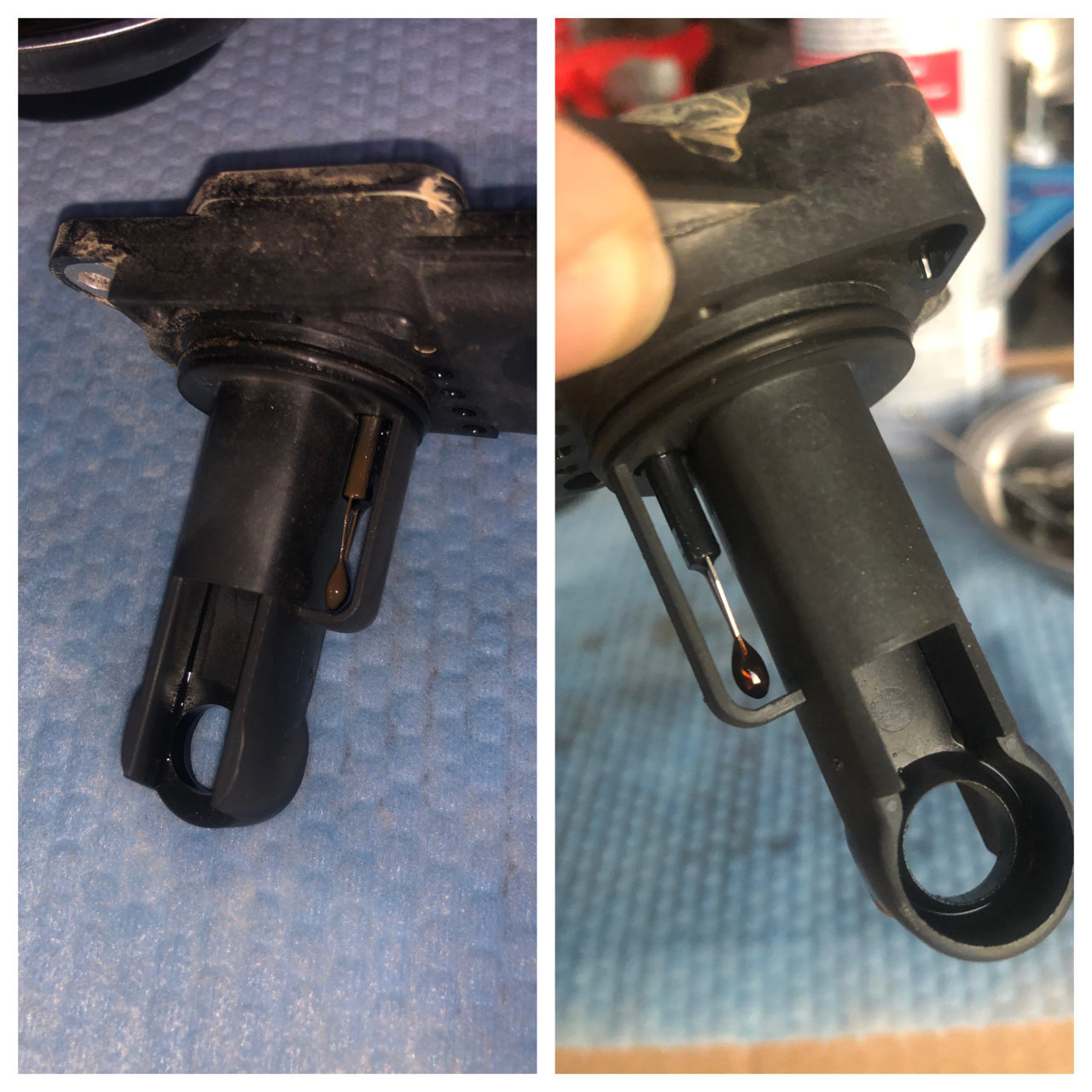

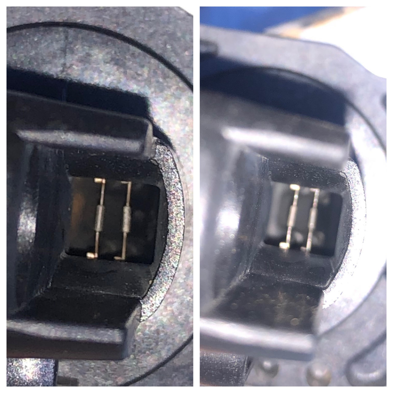

    I need to get some miles in but so far going to say it was a dirty Air flow sensor and MAF. I did not get a good photo of the MAF before I cleaned the AF sensor but you can see how dirty that little guy was. First cleaned the AF sensor and off the back it felt like it had more Pep. Went back and cleaned it again doing the MAF. Topped the tank off and will see how it goes. So far 10 miles and still full tank. Last tank I got 88 miles out of 11.5 gallons of gas. A whopping 7 mpg.
    hoping for at least back to 12 mpg and that a good cleaning was all I needed.
    Don’t forget to clean this little guy. Good time if with everyone air filter change or even oil change.
