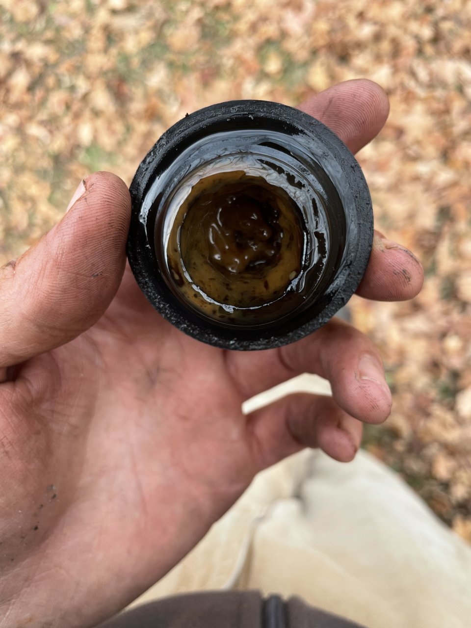

    Hey there,
    I started losing coolant rapidly while driving. Cannot find any leaks. I pulled a spark plug and it looked clean but the inside of my oil cap is gunned up as pictured. Is this a bad head gasket or could it be something else?

    Get a combustion block tester....40 bucks...

    Did you check the dipstick?

    That's likely just sludge, moisture in the oil system. Longer drives helps combat this.

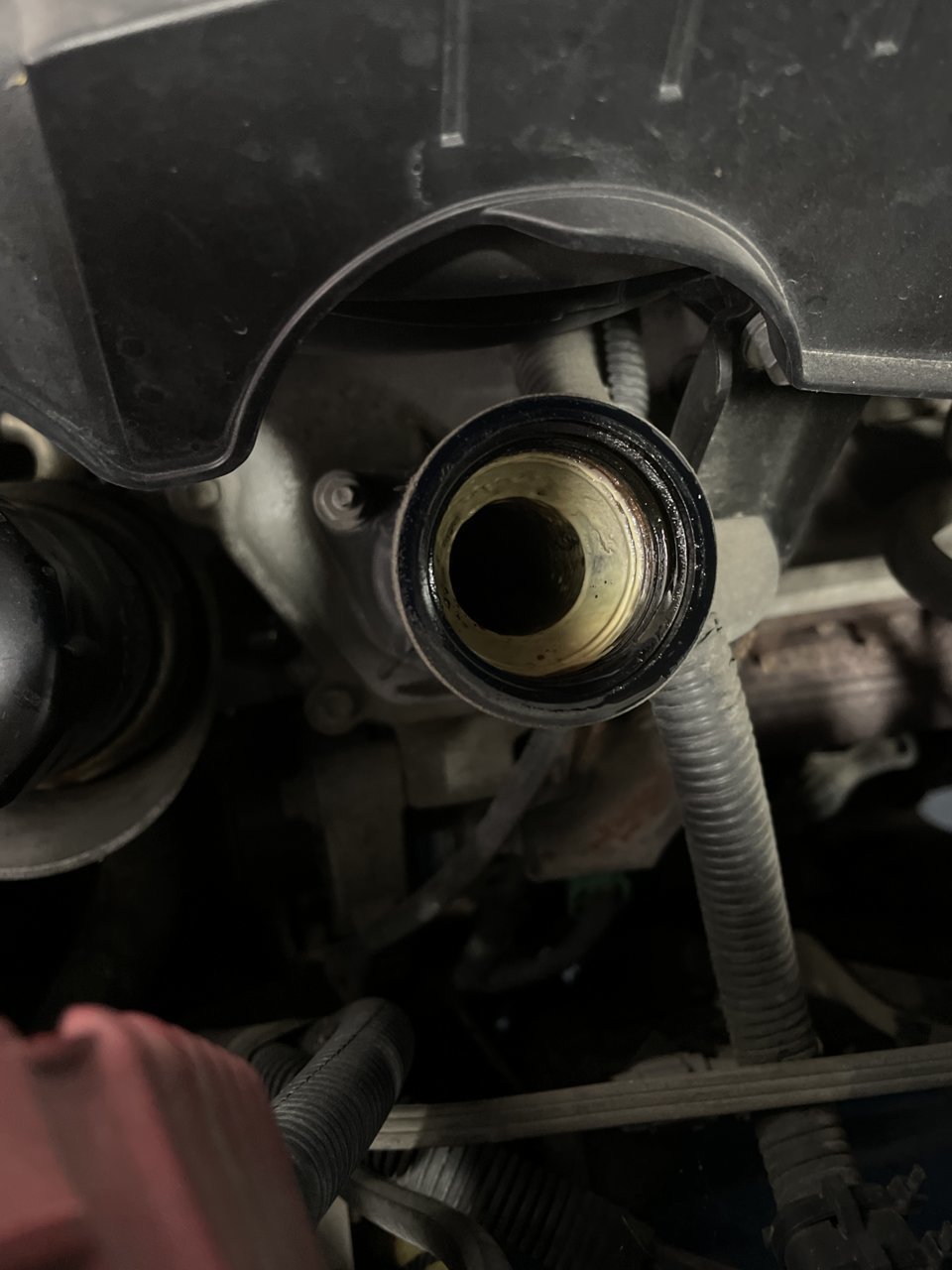

    I took this pic the other day of a 4.0

    Ya it was alarming the first time I noticed that and that was about 10 years ago
    How many miles on OP’s truck?

    After the truck is warmed up, look in the coolant reservoir and see if there is a line of little bubbles coming out. How quickly are you losing coolant?
