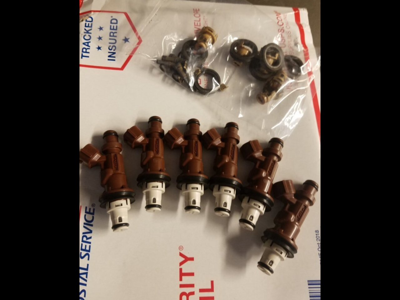

  19. Nov 18, 2020 at 3:55 PM
    #19
    nagorb
    nagorb Should be a dang perma mod
    Feb 28, 2011
    #52025
    9,352
    Alabama
    2001 dbl cab 4x4
    I've been debating on this or a set of their upgraded denso injectors. $100 though.
