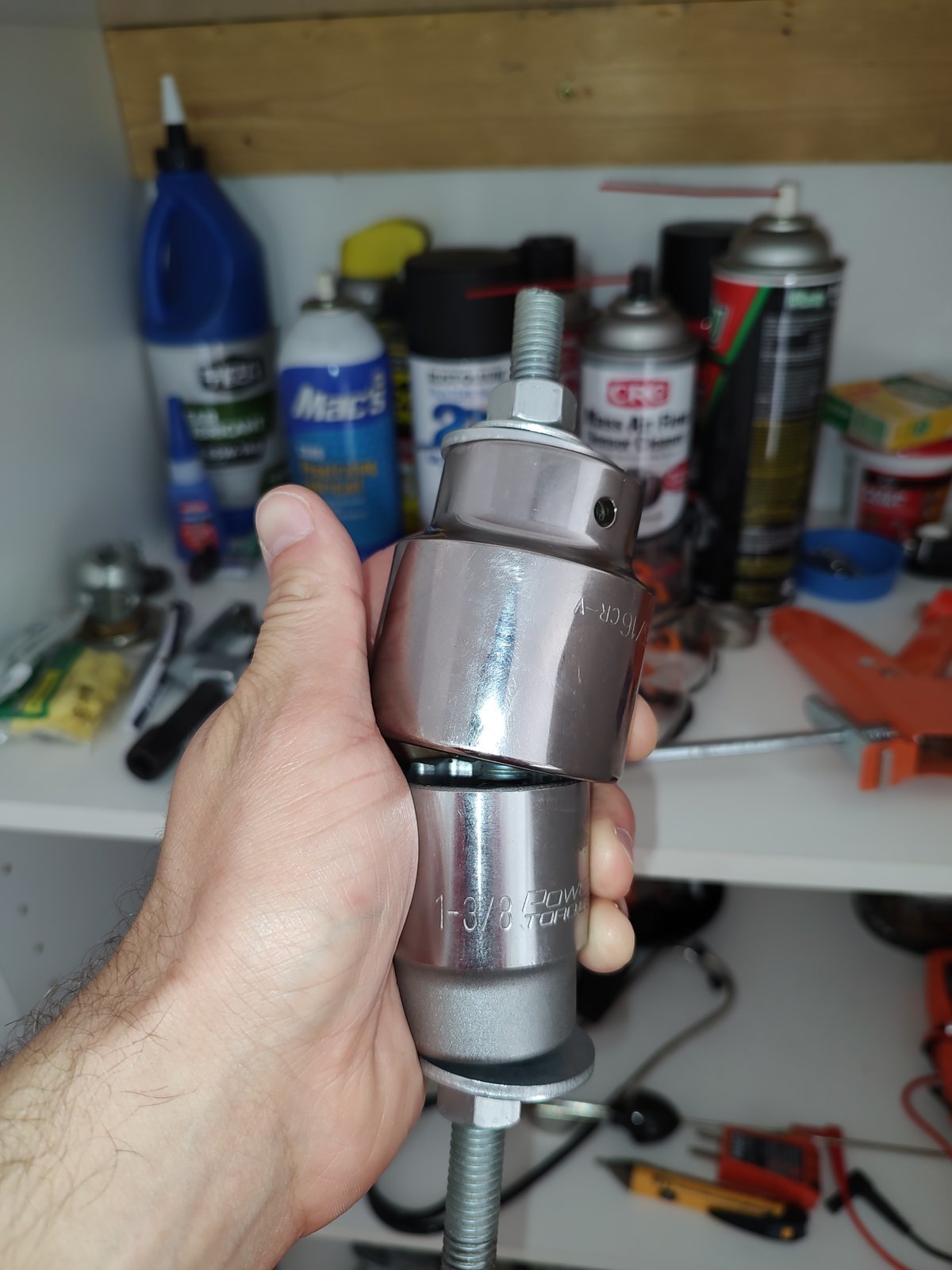

    Just to clarify one thing for people on this topic: you can, (and in my opinion it's easier) do this job without a press at all.
    For Removing the LCA bushings:
    1) Put LCA in a vice with the eyelets oriented vertically
    2) Position bottle Jack between eyelets (pushing down)
    3) Place bucket with rags on ground under LCA
    4) Crank on bottle Jack until tension builds
    5) Gently apply heat to outside surface of LCA eyelet
    6) Bushing should begin to come out, now apply more force by cranking bottle jack further, until bushing is out
    7) Invert LCA and repeat for other side's bushing.
    New Bushing Installation:
    1) Clean bushing eyelet with wire wheel on a drill or brillow pad.
    2) Grease bushing and bushing eyelet.
    3) Using jig (pictured below) and two box end wrenches, tighten opposing nuts to drive bushing into LCA eyelet
    Jig is made of washers, 1/2" threaded rod, and two sockets. One socket is 1-3/8", and I believe the other is 1-15/16", but don't quote me on that second one.
    Will update size on second one when I get home today and look.

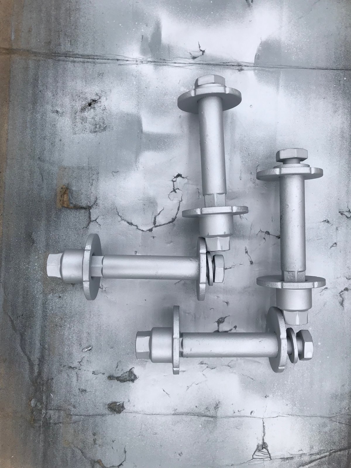

    OP,
    Just to put a little hope into this thread about the serviceability of used OEM alignment hardware, the original hardware on my '97 V6 Taco is still GTG. Just cleaned it all up on a wire wheel and sprayed it with Cold Galvanize (below). This Taco has seen 150-200 days a year in deep mud/high water since it was new. Fortunately, this Taco has never seen any salt spray which is our Taco's worst enemy this side of a major collision. Both rear cams were frozen up with our notorious sandy MS mud when this hardware was removed, but WD-40/PB Blaster/a little heat persuaded it all apart. Good luck!

    I was unable to remove my bushings with a bottle jack on my truck from CO. no amount of PB blaster, heat, and beating under tension worked. ended up buying new Moog LCAs. also going with octagons that delete the alignment cams for better resilience going forward.
    to answer the earlier question, no, having seized alignment cams does not pose a failure/safety issue.
