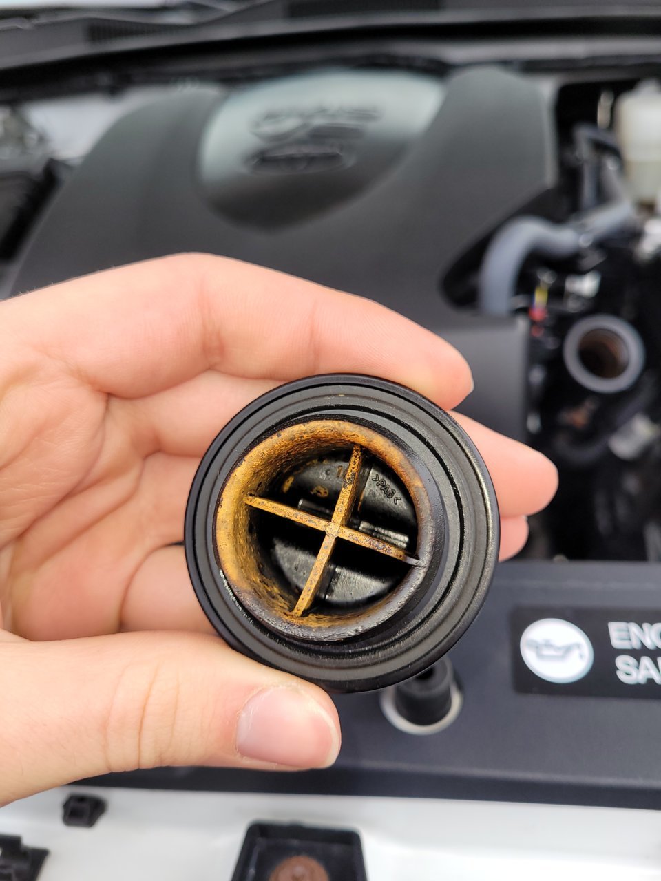

    Alright, enlighten me on this one

    Never seen that before. Looks like water vapor deposits to me though.
    At this point I'd show that to the GM and convince them that it would cost them less money if they just bought the damn thing back. Maybe even schedule a meeting where they drain the oil in a place where all of you can watch.

    Me personally it appears to be rust, which I mean I've seen it in the cooling system even to some degree on the engine block if it sits out in the open for a while... but then again, this is the oil filler neck and the truck was driven up until I bought it based off service records

    Not saying it's okay but clarification on what it looks like. Never actually had rust there on my past vehicles

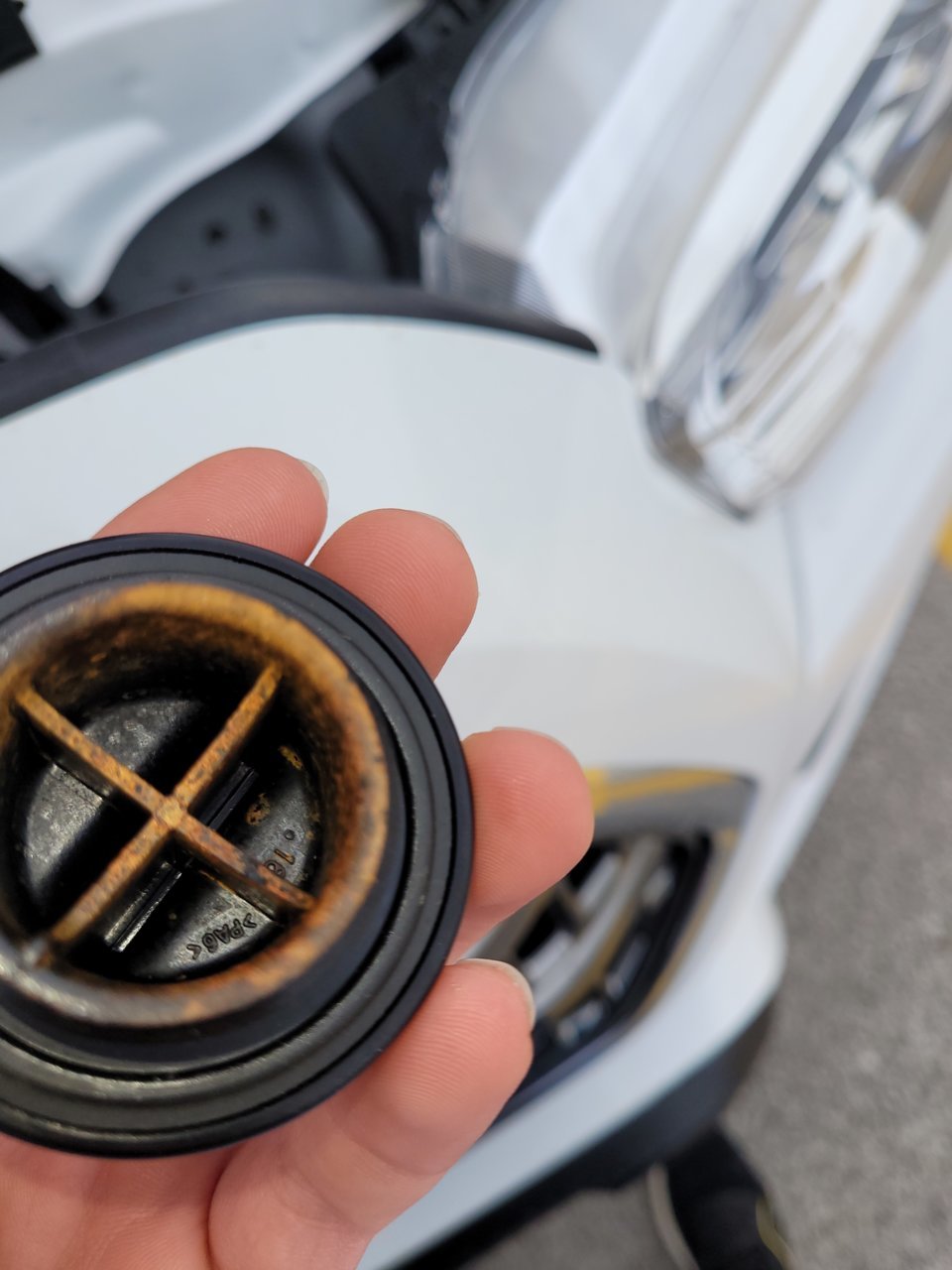

    Rust on the bottom of the oil cap indicates water to me. Whether condensation or coolant, water with dissolved iron will vaporize when the engine is hot, meet the bottom of the oil cap, and deposit whatever was in solution. That much rust deposit indicates that you have a lot of water in your oil pan, more than what can be explained by simple condensation.
    I'm just going by what makes sense, since oil vapor doesn't carry as much solubles.

    This is not great news but makes sense as to why it's there. The oil on the stick is pretty clear but not behaving like water thankfully

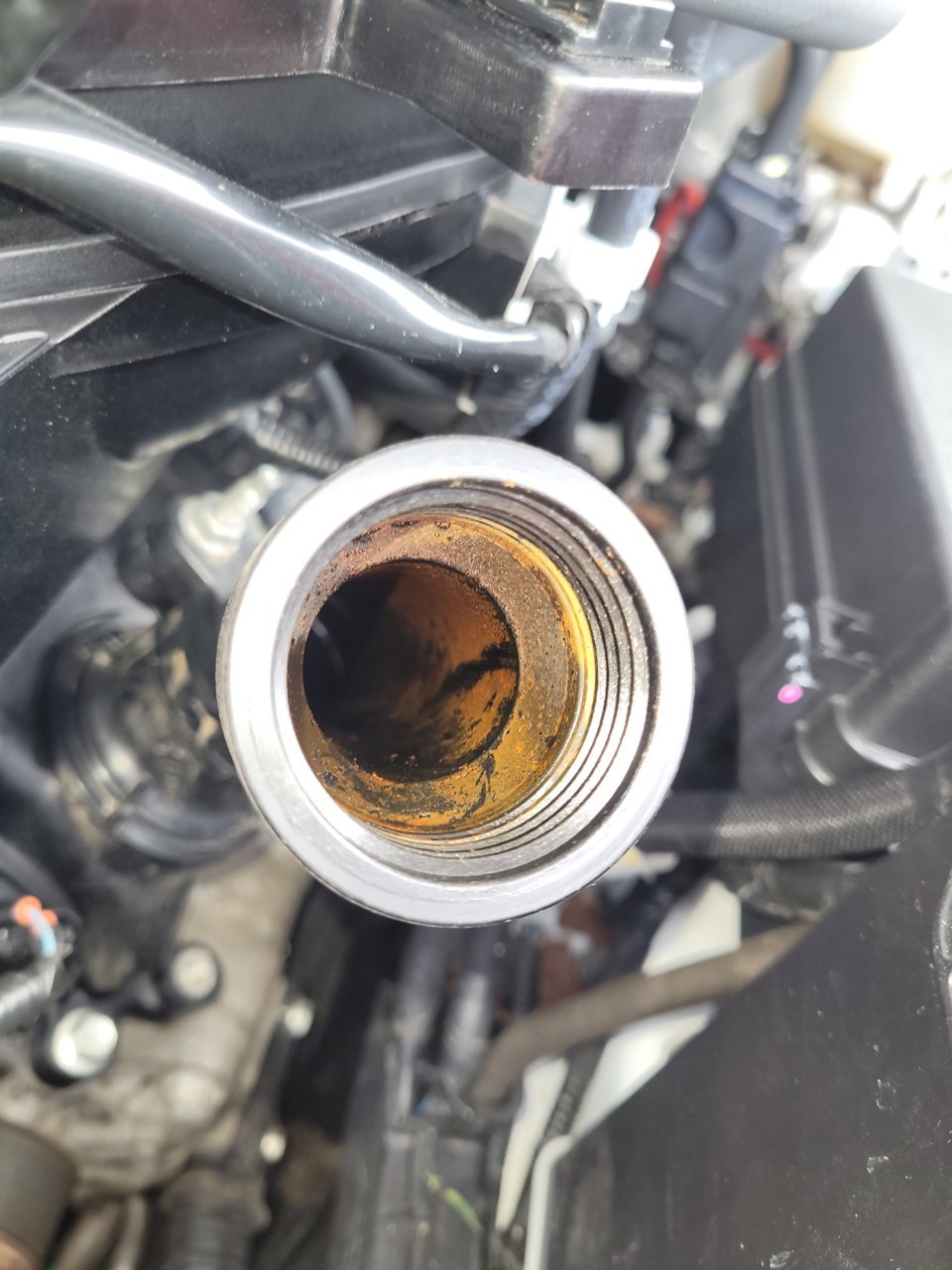

    Better pics

    there is a coolant hose on the back of the engine, connecting the heads. That may be where the leak is, it is hard to see.

    Yeah I grabbed a scope to look back there. Definitely hard to see, it's tough since it's been raining here but there was a little dampness
