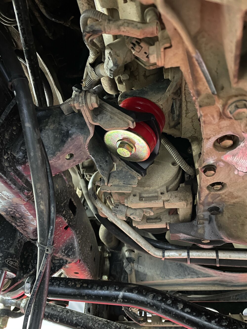

    Mine went bad. I think they are a shit design to begin with. Replaced with solid off road.
    mine were clunking every time I stopped. I could feel the motor moving. Especially on older years that can put a hole in the frame that’s not easy to repair and wasn’t looking to experience that.
    I don’t think they’re that cheap either. And for the difficulty of the job (it’s not a walk in the park) I wasn’t looking to go through all of that wrenching just to put another pair of cardboard.

    I mean you can try OE if you want. Or other brands like Martec and see how you like it. Up to you.
    just be advised it’s a bitch of a job if the truck is 4x4 with all that other parts in the way from front diff axles etc
    depending on location
    And popularity of solid off road
    Might not be hard for you to find a truck with them go for a ride see how they feel.
    if it’s not thudding/clunking when you come to a stop then it’s probably fine
    For example. Worn. Switching from on gas rotating it one way, to off gas and braking, making a clunk
    or rev under load and watch for movement under hood but you kinda already did that
    mine didn’t vibrate it was just the thudding basically

    I've never seen a motor mount or transmission mount that needed replacement unless it had broken or unbonded the rubber between the metal mounting plates.
    Put a jack under the motor and try and lift it while watching the mounts to see if they separate. If they do replace them. Short of a recent wreck or impact I doubt the mounts are bad.
    Another way we used to test the mounts is to place it in drive gear engine running and hold the brake hard and rev the engine when watching look for excessive lifting then do the same on the other mount by placing it in reverse gear and reving... That should reveal a broken mount.

    "Some" motor mount movement, esp. on a >75K mile or more truck, is normal. The stock mounts are intentionally relatively "smooshy" to help reduce NVH & increase vehicle occupant comfort (for those who think in those terms.)

    Your motor mounts are just fine. They are doing what they are designed to do: absorb the shock of the engine torque. There is very little clearance between the fan shroud and the fan blades. IF one of the mounts were broken loose, the fan would hit the shroud.
    I'd bet that if you do change them with new mounts, the engine will move just as it does here with the old mounts.
    I've seen many trucks that have a bounce feeling in the body and it can usually be tracked down to a defective tire or a balance issue.
