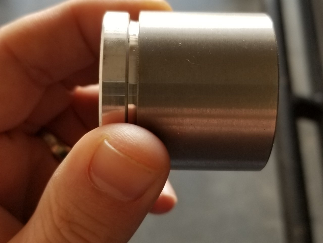

    FWIW, I found the bearing and race driver tool to be useless. I think I just used the flat side of a bigger socket. There wasn't enough room to strike the rod end of the race driver and the smallest one was just a hair too big to fit inside the bushing properly.

    I’ve installed probably 4-5 with the smallest one and it works perfectly. I just use the handle of my jack or a piece of pipe so I can essentially extend the handle, and get a good swing on it.

    My experience with the small one. Any impact would just get it stuck in there... unless you are using the backside.
