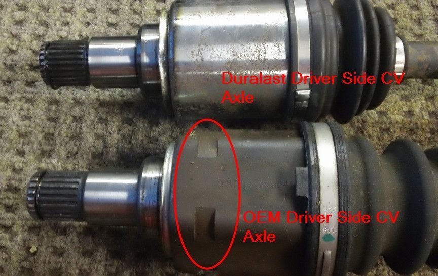

    The hardest part is getting the CV out. When you are looking at the back of the CV you will see notches where you smack a rod against with a mallet to get it out (wrap the tip of the rod, chisel, screwdriver...ECT with electrical tape first to avoid marring). Looks like this:
    Oh, and don’t let 4 Wheel Parts do this job...they are idiots
