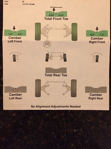

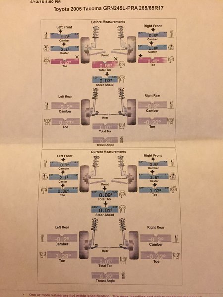

    Found a couple more alignment measurements. This first alignment was done about 2.5 years after the initial alignment, after noticing a large amount of wear on the outside edges of the tires. Guess the before measurements kind of explain that with the combo of camber and toe being as far away from zero as they were.
    This last one was just a check I guess, although a pretty bad one at that, in that it doesn't even give values... about two months ago. It looks fairly decent as far as the alignment goes. But guess I should go ahead and have it done again, since I just put new tires on.
